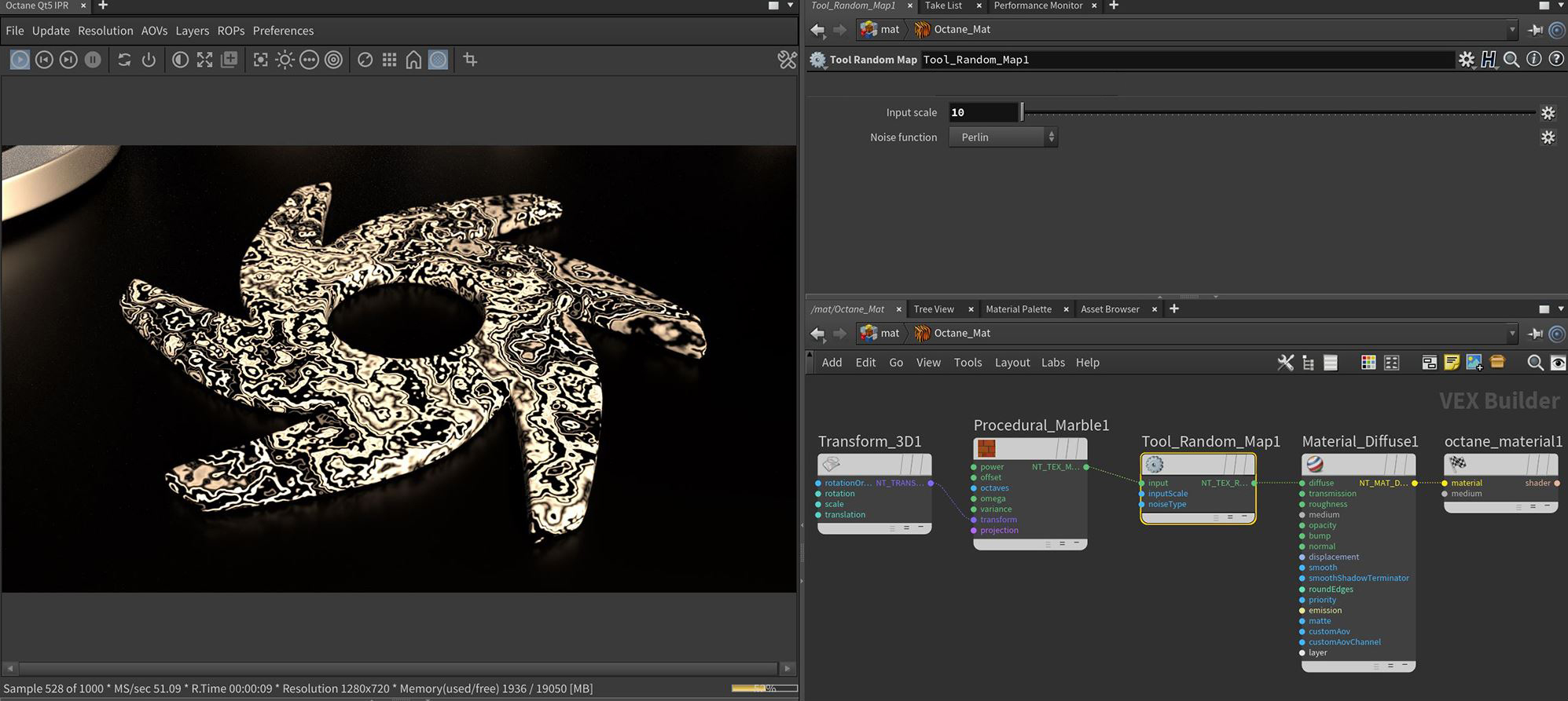

The Random Map node will randomize the input texture with the selected Noise Function; Perlin, Unsigned Perlin, Cell and Hash (figure 1). The Scale slider will attenuate the result.
Tool Random Map
Figure 1: The Random Map node used to modify the output from a Marble Texture node
