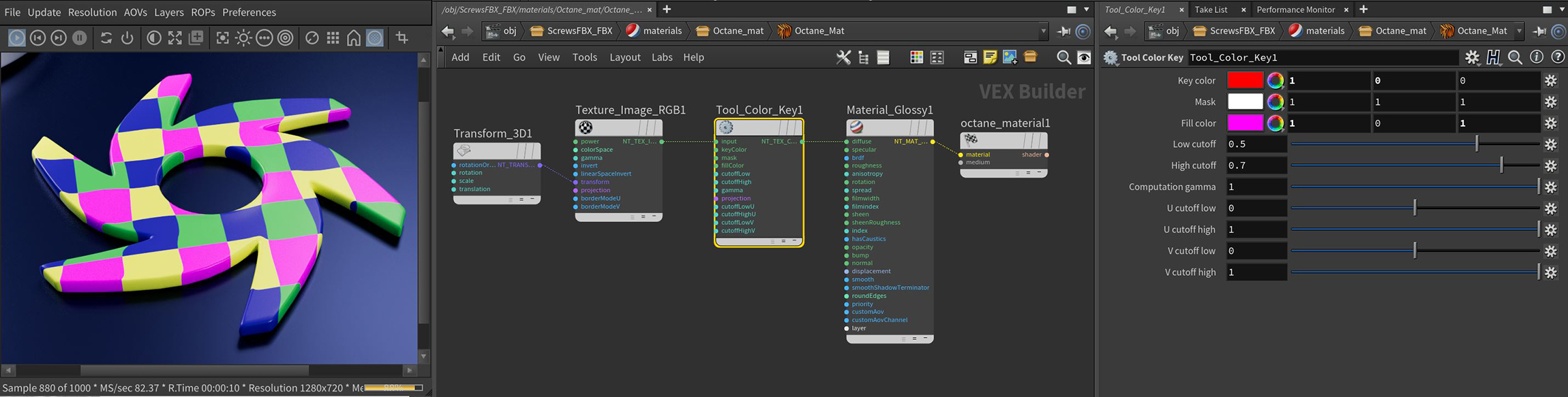

The Color Key node is used to key out a specified color in a connected texture map (figure 1).
Tool Color Key
Figure 1: The Color Key node used to key out the red color on a connected texture map and replace it with pink
