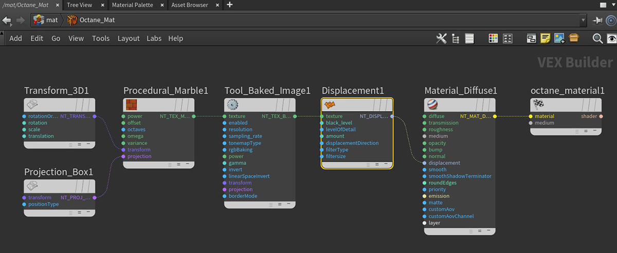

In Figure 1, the Baked Image node takes an input from any Procedural texture map, then it connects to a Displacement node, which connects to the Displacement pin on an Octane material.

Figure 1: A typical node network setup for using the Baked Image tool
