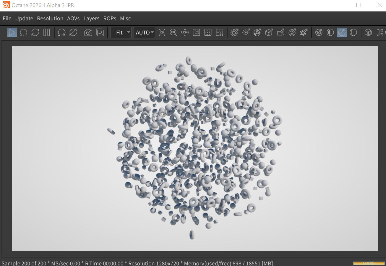

The Scatter on Volume node generates an arbitrary number of instances according to various patterns and distributes them in a volume (figure 1).

Figure 1: The Scatter On Volume node used to scatter instances in a spherical volume shape

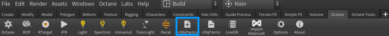

The Scatter on Volume node should be added to an Octane VOP NET in the MAT network. A Geometry node should be added to the OBJ network and the this node will be used as the scattering volume. The Octane +ObjParams should be added to this geometry node (figure 2).

Figure 2: Adding the Object Parameters to the scatter Geometry node

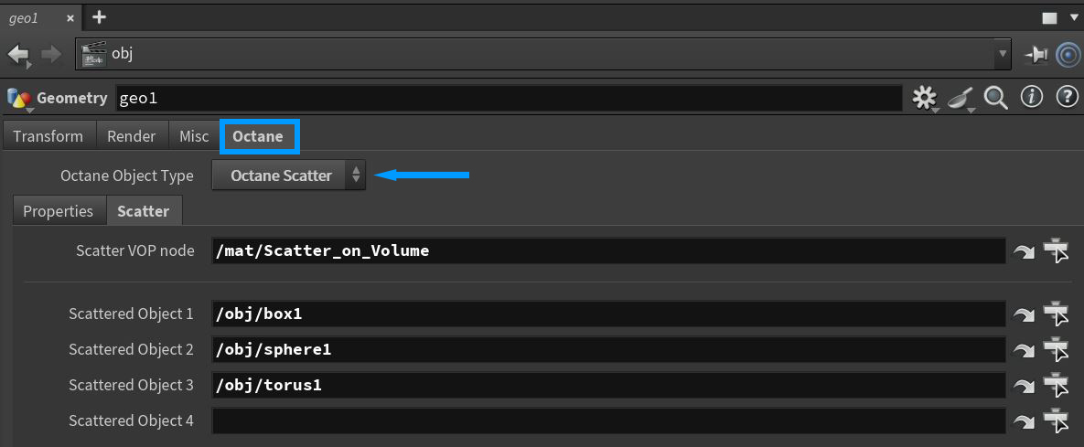

Set the Octane Object Type to Octane Scatter in the Octane tab (figure 3). The Scatter tab is where all the connections are made for the scatter system to function properly. The Scatter VOP Node parameter should point to the Scatter on Volume node in the MAT network. The Scattered Object 1-4 parameter should point towards the objects to be scattered.

Figure 3: The Scatter parameters required for Scatter on Volume to function properly
