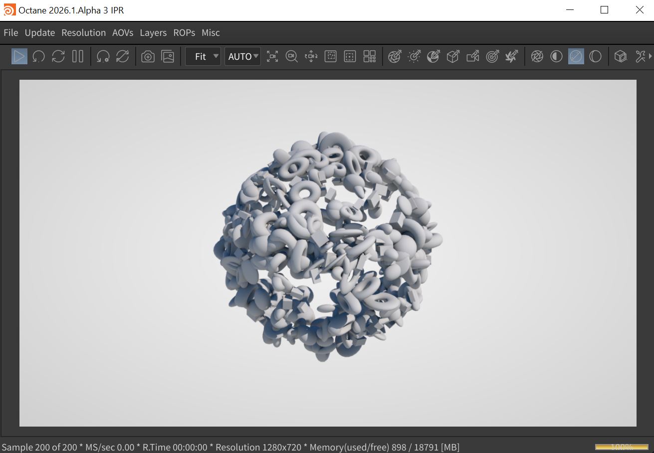

The Scatter on Surface node generates an arbitrary number of instances according to various patterns and distributes them across the area of a surface (figure 1).
Scatter On Surface
Figure 1: The Scatter On Surface node used to scatter instances across a sphere shape

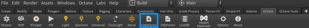

The Scatter on Surface node should be added to an Octane VOP NET in the MAT network. A Geometry node should be added to the OBJ network and the geometry in this node will be used as the scattering surface. The Octane +ObjParams should be added to the geometry node containing the scattering surface (figure 2).
Scatter On Surface
Figure 2: Adding the Object Parameters to the scatter Geometry node

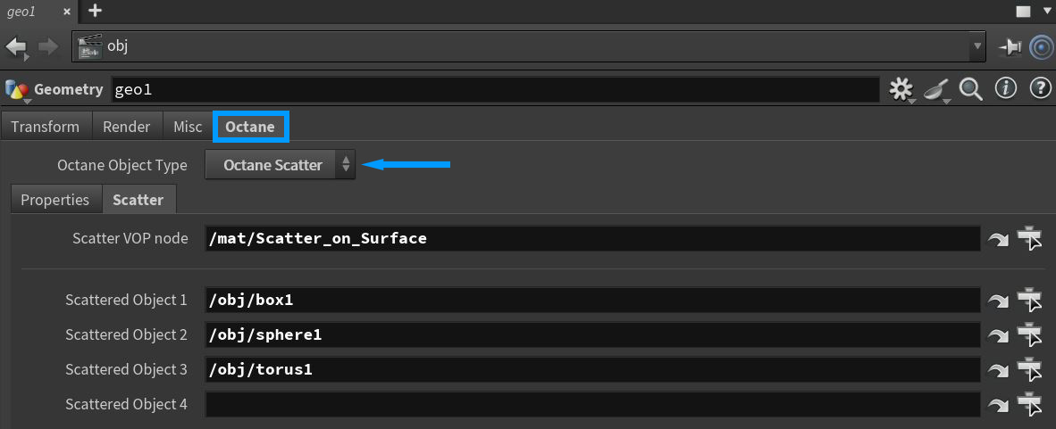

Set the Octane Object Type to Octane Scatter in the Octane tab (figure 3). The Scatter tab is where all the connections are made for the scatter system to function properly. The Scatter VOP Node parameter should point to the Scatter on Surface node in the MAT network. The Scattered Object 1-4 parameter should point towards the objects to be scattered.
Scatter On Surface
Figure 3: The Scatter parameters required for Scatter on Surface to function properly
