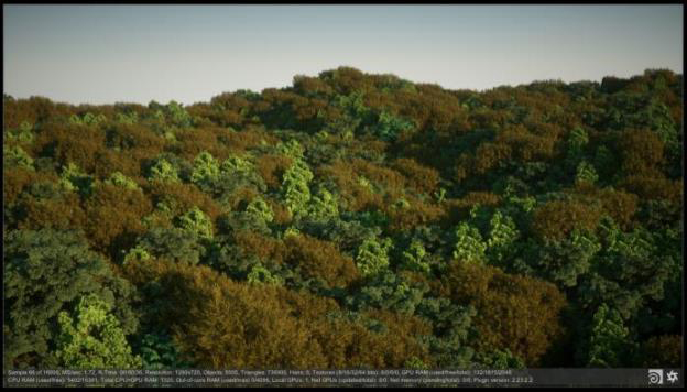

Figure 1: Instanced geometry rendered with OctaneRender®

The OctaneRender plugin has full support of the Houdini Instance node, including any kind of Transformation and Instance parameters, if available, in the objects points. It also supports the root instancer object node transformations. Instance motion blur is rendered, including multi-step motion blur for both IPR and final rendering. The Shop_materialpath and Material_override attributes are not supported.
