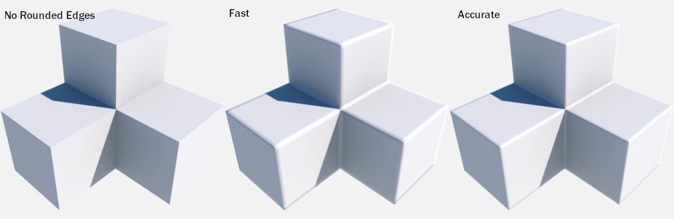

The Round Edges node rounds off geometry edges by using a shading effect instead of creating additional geometry. It’s best used for rounded edges that will appear small in the final render (Figure 1). It is plugged into the Round Edges input on an Octane material. The Round Edges node can be found in the Procedurals section of an Octane VOP NET.
Round Edges
Figure 1: The results of the Round Edges node.
