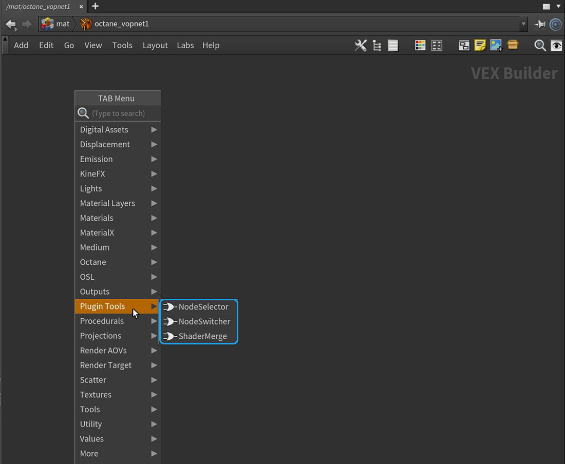

There are three additional custom nodes available inside Octane VOP NET nodes: NodeSelector, NodeSwitcher, and ShaderMerge. These are not standard OctaneRender® nodes, and can’t be used by the shaders at render time. They can be used only at loading time as node tree selection tools to build node trees, or HDAs with selection parameters. These nodes can be found by right-clicking or pressing the Tab key while in an Octane VOP network (Figure 1).
Plugin Tools
Figure 1: Accessing the Plugin Tool nodes in an Octane VOP network
