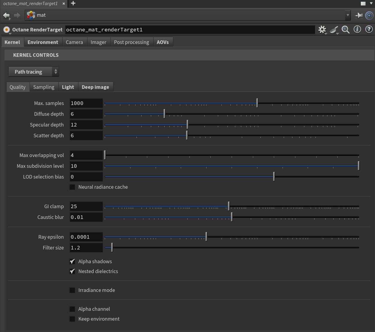

Figure 1: Path Tracing Kernel parameters
Path Tracing Kernel Parameters
Quality Tab
Max Samples - This sets the maximum number of samples per pixel before the rendering process stops. Higher values result in cleaner renders. There is no rule as to how many samples per pixel are required for a good render - it depends on the scene.
Diffuse Depth - The maximum number of times a ray can bounce, reflect, or refract in a high roughness or diffuse surface. Higher values mean higher render times but more realistic results. For outdoor renders, a good setting is around 4. For lighting interiors with natural light from the sun and the sky, you need settings like 8 or higher. While high values are possible, in reality, rays will not go beyond 16 ray bounces.
Specular Depth - The same as Diffuse Depth, but for low roughness surfaces like reflections or refractions.
Scatter Depth - The maximum path depth that allows scattering.
Maximal Overlapping Volumes - Determines how much space to allocate for overlapping volumes. Ray marching is faster with lo values but it can cause artifacts where many volumes intersect.
Max Subdivision Level - The maximum subdivision level applied on the scene's geometry. A value of 0 disables subdivision.
LOD Selection Bias - Used in conjunction with Meshlets. This setting influences the LOD data selection. Decreasing this value will make the loaded LOD data cruder and increasing this value will make the loaded LOD data finer.
Neural Radiance Cache - Enables neural radiance cache which activates the adaptive neural network at runtime significantly reducing noise on first pixel.
GI Clamp - Clamps the contribution for each path to the specified value. By reducing this value, you reduce the amount of fireflies caused by sparse but very strong contributing paths. Reducing this value reduces noise by removing energy.
Caustic Blur - Increasing this value results in less caustic noise.
Ray Epsilon - The distance to offset new rays so they don’t intersect with the originating geometry. This value should be left at the default setting.
Filter Size - This sets the pixel size for the render filter. This improves aliasing artifacts in the render. If the filter is set too high, the image becomes blurry.
Alpha Shadows - This setting allows any object with transparency (specular materials, materials with opacity settings and alpha channels) to cast a shadow instead of behaving as a solid object.
Nested Dielectrics - If disabled, the surface IORs are not tracked and surface priorities are ignored.
Irradiance Mode - This setting works similar to Clay Mode, but is applied to the first bounce, disables Bump, and makes samples that are blocked by back faces transparent.
Alpha Channel - This option removes the background and renders it as transparent (zero alpha). This can be useful if you want to composite the render over another image and don't want the background to be present.
Keep Environment - This option works in conjunction with the Alpha Channel setting. It allows the background to render with zero alpha, but is still visible in the final render. This allows even further flexibility in compositing images.
