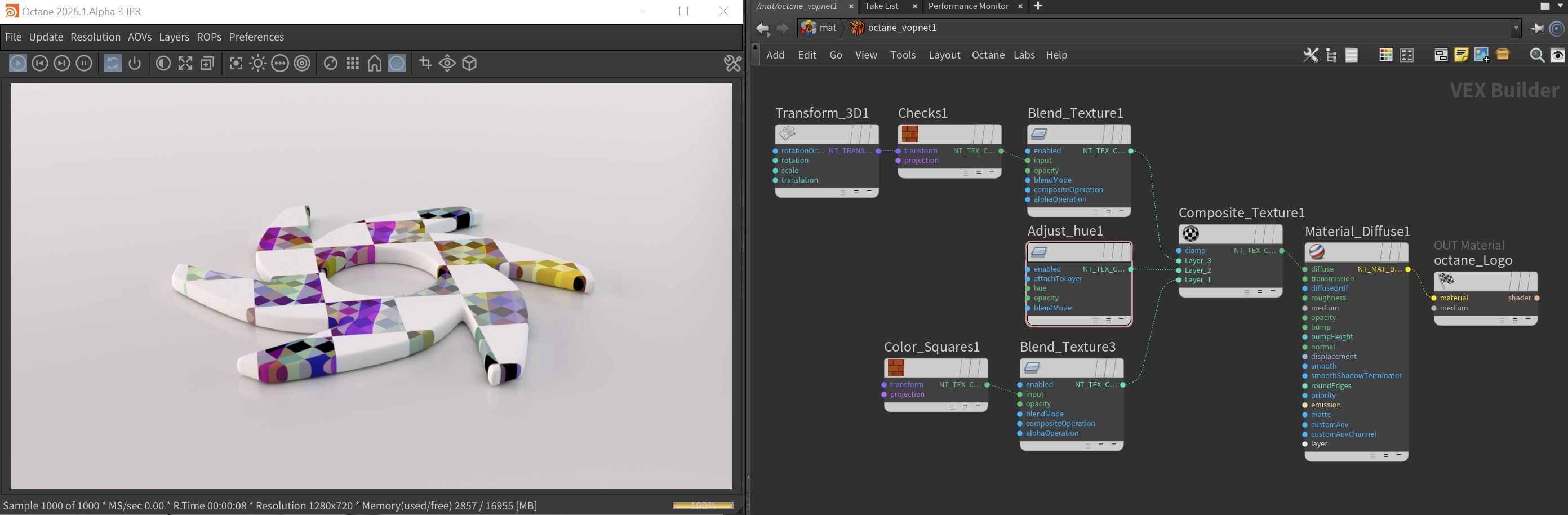

The Blend Texture node is where texture maps are added to the Texture Layers system. Texture maps can be connected to the Input pin. The Blend Texture node is then connected to a Composite Texture node's Layer pins (figure 1).
Blend Texture
Figure 1: A Texture Layer node structure example
