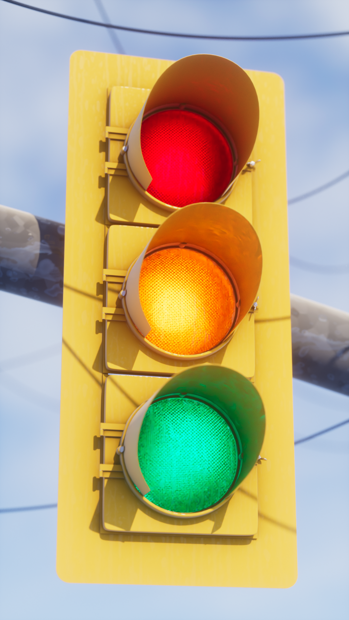

The image below uses the Gaussian Spectrum node to set the color of the lights in the traffic signal. The colors in the traffic signal represent a good use case for the Gaussian Spectrum node, as these lights produce very saturated color while maintaining brightness, something that the Gaussian Spectrum node can do better than the RGB Spectrum node.

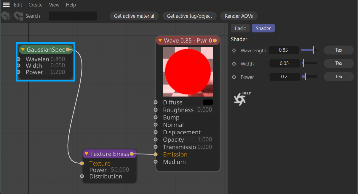

Octane remaps the Wavelength, Width and Power values of the Gaussian spectrum into a range from 0.0 to 1.0. This is due to Octane expecting a 0-1 input for all texture nodes, so it is not possible to enter . To make it easier to get the desired color, we have put together a simple Cinema 4D scene, consisting of a Cube Object with an Octane Diffuse material applied; a Gaussian Spectrum node is piped into the Diffuse input of the material. Launch Live Viewer and make adjustments to the Wavelength, Width and Power values to dial in the color you need, then copy that node into your material or light in the Texture slot. You can pop out the Attribute panel and lock it the Gaussian spectrum node to make your adjustments, if you wish. Use that scene as you read through the rest of this topic.

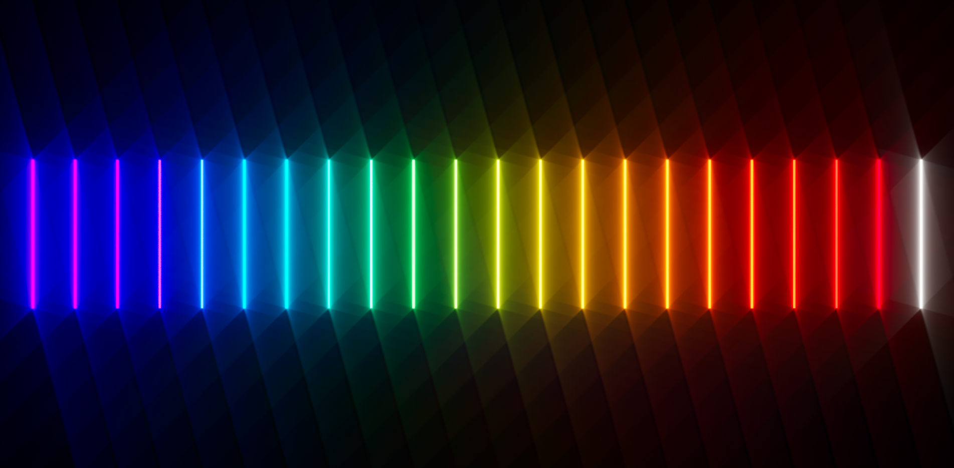

The Gaussian node can be connected this node to any color-compatible input on any given node. The example below shows a cascade of increasing frequencies, from cool to warm. The Gaussian spectrum Wavelengths in this image are re-sampled from 0.0 to 1.0; Width and Power values were adjusted for artistic preference.

Wavelength
As Scott Benson notes in his excellent Lights and Emission in Octane for Cinema 4D article, Wavelength is roughly the same as Hue in the HSV color model, though not completely. This represents the mean wavelength approximation between 380nm – 720nm, which Octane remaps into 0.0 to 1.0. The lower wavelength values will be in the blue range while higher values be in the red range.
Width
The Width value controls the prevision of the resulting color as set in the Wavelength value, from fully saturated to white-ish. Width is not exactly the same as Saturation in the HSV color model, as there are inter-dependencies with both the Wavelength and the Power values. You can imagine this width value as a spread, from black at 0.0, and completely faint at 1.0. Scott Benson recommends using the value of 0.05 for the width, as this gives a narrow-enough result. Some wavelength values do better with this recommendation than others, so keep that in mind.
Power
You can control the brightness from here.
