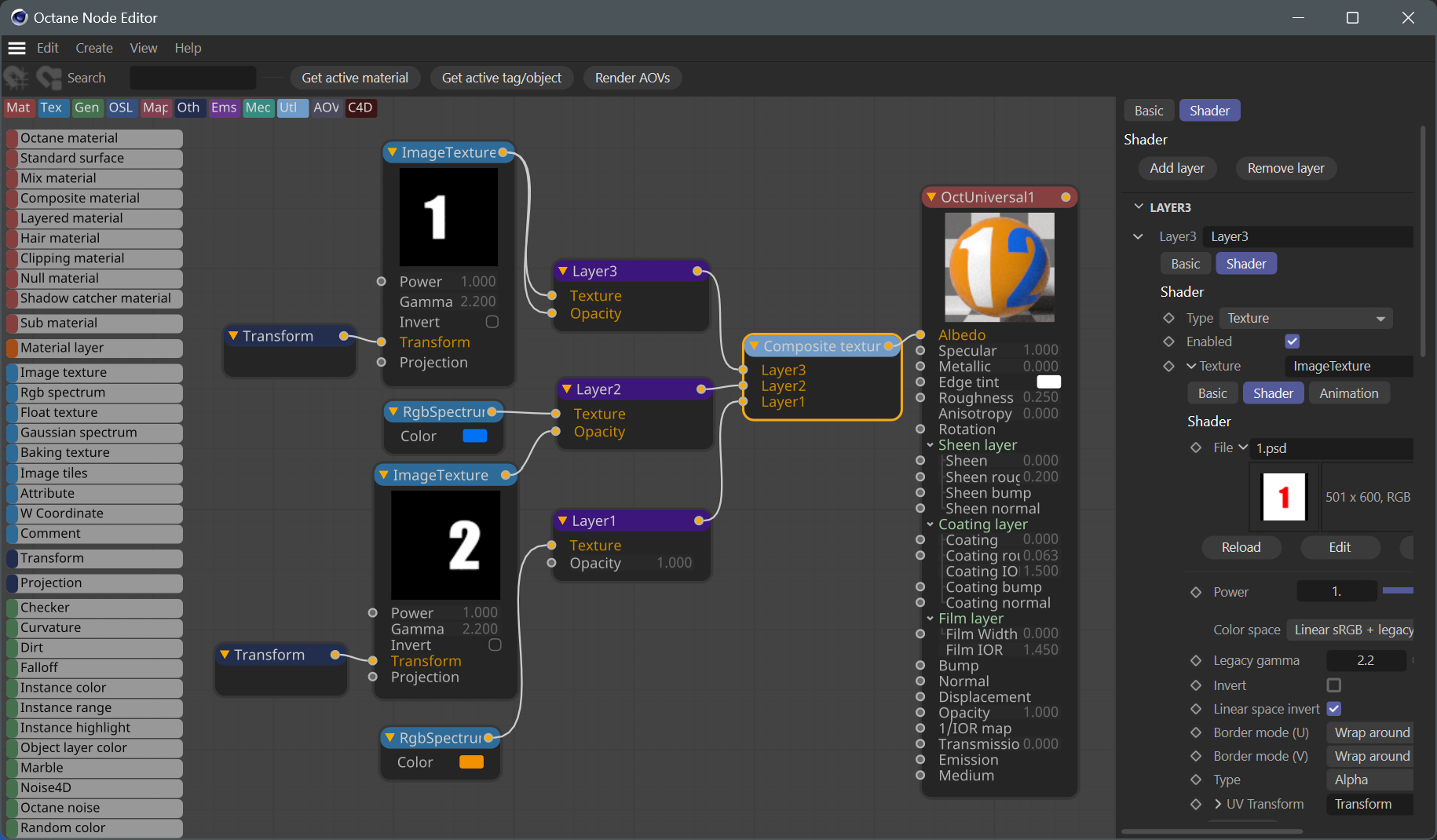

The image below is a sample node graph showing the basic components:
composite texture node

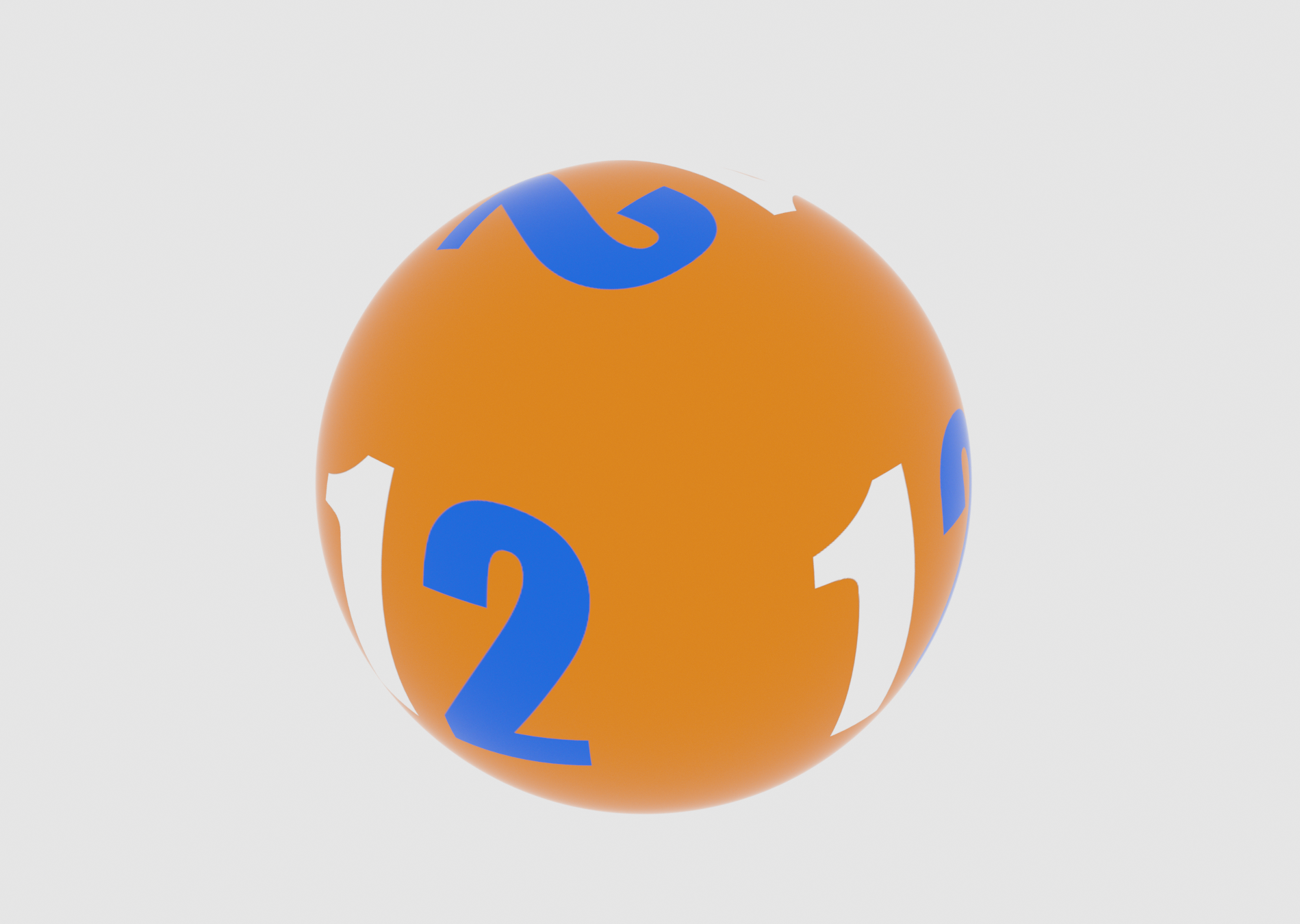

In this example, a Composite Texture node is connected to the Albedo pin of a Universal Material. The colors are derived from RGB spectrum nodes, and two Image Texture nodes, each with an alpha matte, are used to derive the numeric shapes. The rendered result is seen here:
The Composite Texture node control panel to the right of the user interface image shows the three Composite Texture Layer inputs, along with the settings for each layer:
    • Type Menu (defaults to Texture)
    • Enabled flag
    • Opacity
    • Blend Mode
    • Overlay Mode
    • Alpha Operation
These operations, with the exception of the Overlay Mode, are discussed in the Composite Output Layer node topic, here, as they are identical in function.
