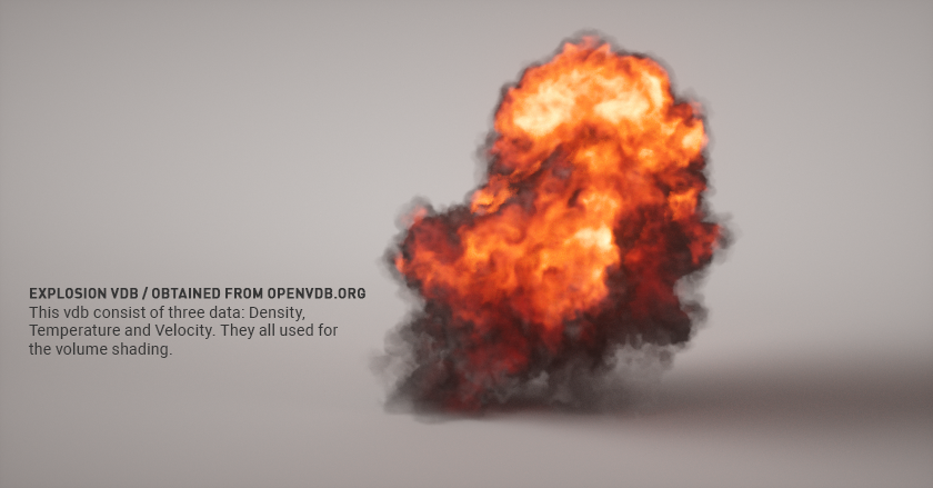

Click on the ellipsis button to get the file loader dialog and choose the VDB to load from the file list. In the lower right section of the panel is an information window with statistics about the loaded VBD. In the illustration above, the information in the window is from the VDB file seen in the image below (available from OpenVDB.org). In the Grid Mapping turndown, there are selectors for the Density, Temperature and Velocity channels that correspond to the

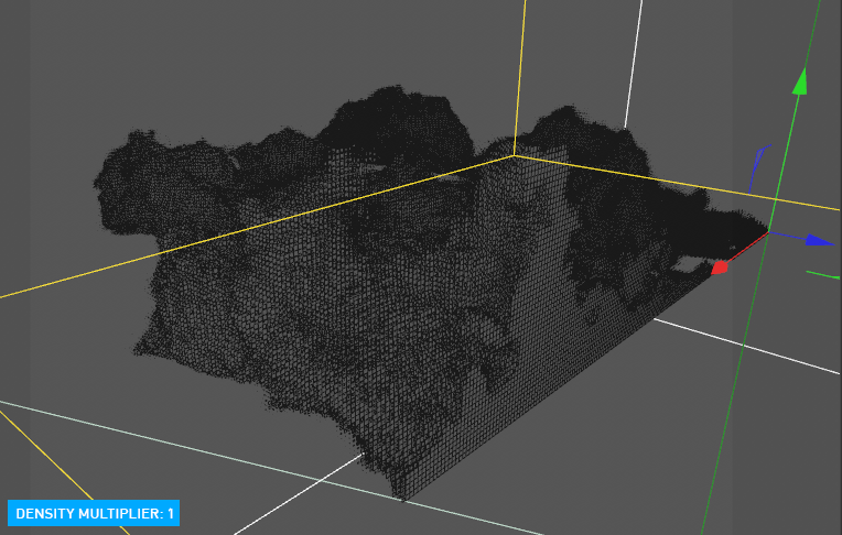

Voxel Display
The "Voxel Display" enables or disables the display of the voxel dataset in the standard Cinema 4D Viewports. Heavy VDB display settings will definitely impact the responsiveness of the scene. "Density Multiplier" can be used to increase and decrease the density of voxel in the viewport. The default option 1 is ideal for most scenes.
volumetrics — density multiplier

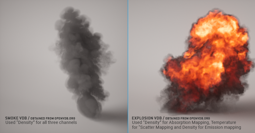

The Scale fields next to the channel names can be used to increase or decrease the energy of a given channel from the stored value in the VDB file. For example, in the image below, the absorption / density scale value 20 is entered to the explosion VDB (on the right side). Thus, the effect of black smoke is spread throughout the voxel grid and more pronounced.
