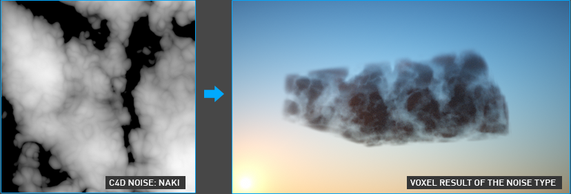

Press "Cloud 1" from the Preset buttons on the Generate Tab. This preset will update the voxel display and add a Cinema 4D Noise node the texture slot. This noise type is now driving the data represented in the Voxel grid, creating 3D voxel data from 2D procedural data. The noise type can be changed to produce a variety of volumetric effects. The noise texture in this preset is "Naki".

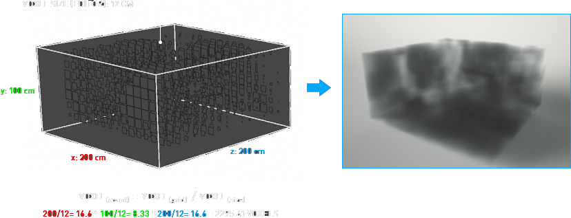

These 2 options work together. Here you can set the Voxel size and number. The most important issue when working with voxel based is to make the right settings for voxel grid and voxel size. Because both GPU power and VRAM are used extensively and render times are quite high. So, you have to make these settings exactly according to your purpose. You can use the following formula when making both adjustments:
For example, if the Voxel grid size to x200 cm / y100 cm / z200 cm and voxel size to 12 cm, the number of voxels generated is 2294.41 according to this formula. This resolution is not appealing, but it will render quite fast, as shown in the illustration below.
volumetrics — voxel GRID size

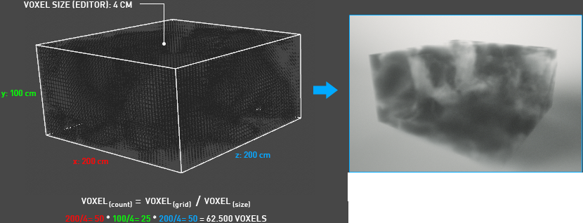

Keep the grid size the same but change the voxel size to 4 cm. The number of voxels will be 62,500 according to the same formula. At such a voxel resolution, the use of GPU power and VRAM will increase and will render slower, but the quality will be much better. Do not make large changes to these values; go in small steps, as a tremendous amount of data is being generated — as the voxel size moves closer to zero, an extreme amount of memory will be consumed, and that can lead to instability.
volumetrics — SMALLER VOXELS

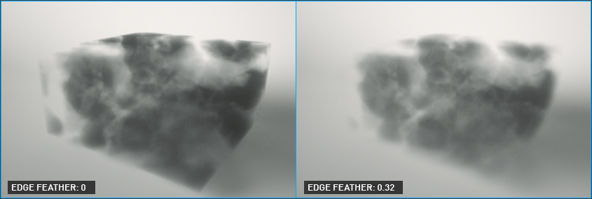

Edge Feather
This option is used to feather the edges of voxels, which will impart a softer, less dense look.
volumetrics — edge feather

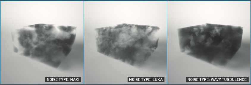

Texture
Use this slot to assign a Cinema 4D noise texture to define the volume.
volumetrics — noise
