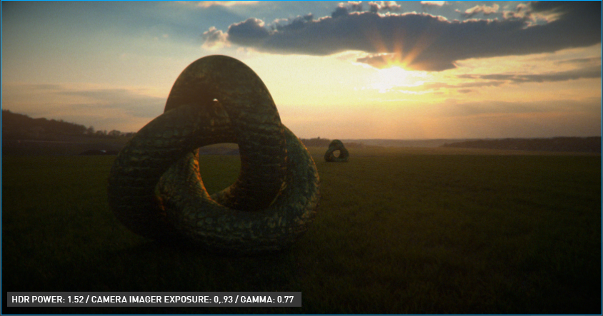

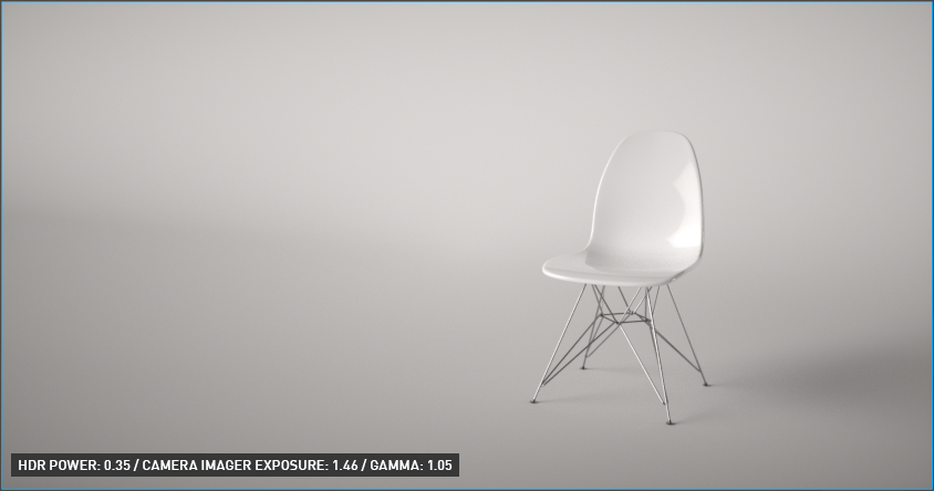

Power
You can adjust the amount of lighting contribution to the scene from the HDR image. The value is completely dependent on the light values within the HDR image. The quality of HDR images can vary, so the Power adjustment can be used to help. When using HDR images, be sure to keep the gamma value set to 1.0.
HDR/TExture environment — exposure

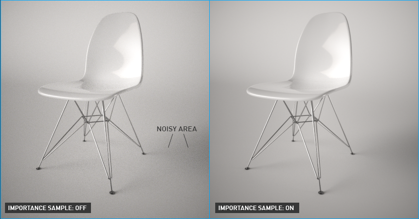

Importance Sample
Enables quicker convergence (noise reduction) for HRDI images by applying importance to certain areas of the HDRI so as to sample rays that resolve to the important areas more often than unimportant areas.
hdr/texture environment — importance sample
