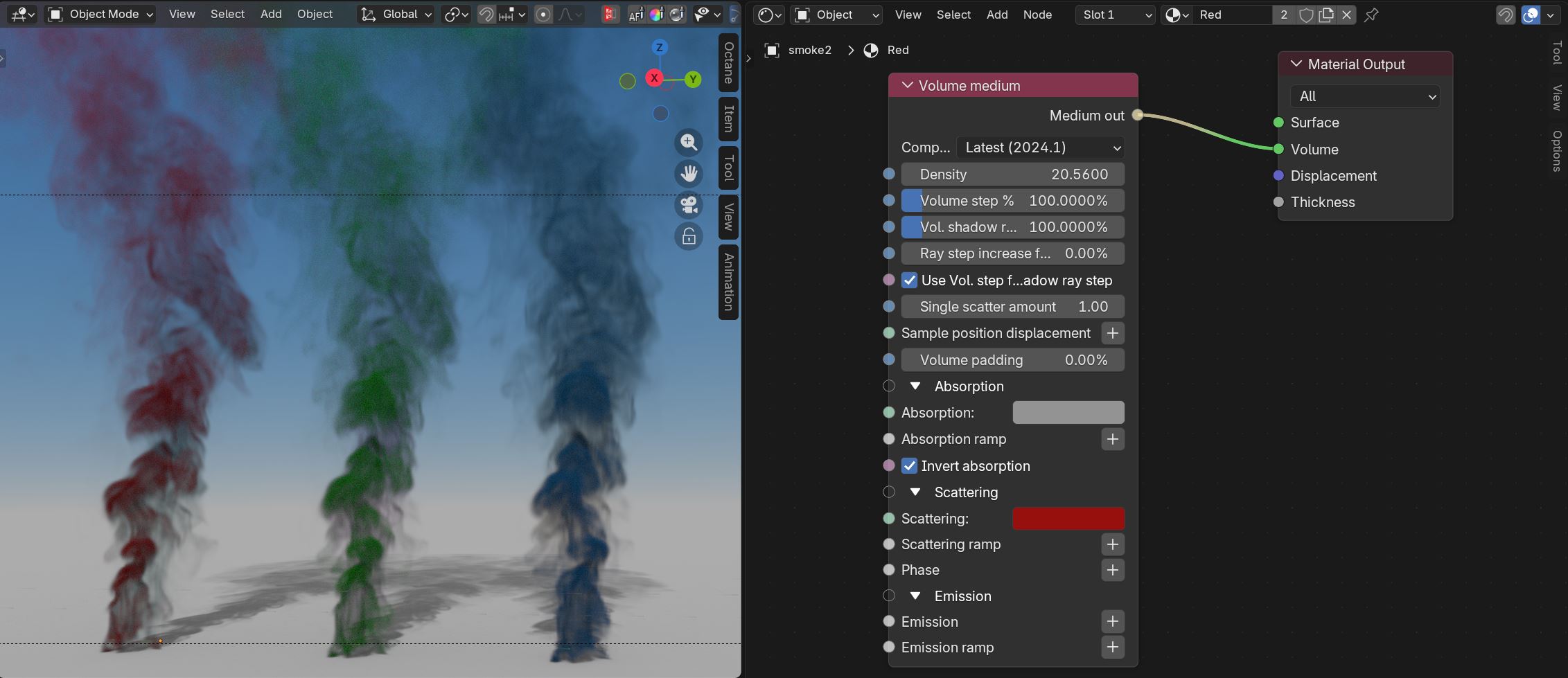

Volume Medium adds color and other qualities to a VDB file. VDBs are a generic volume format that create effects such as smoke, fog, vapor, and similar gaseous objects. VDBs are generated and exported from other 3D software programs. You can also download VDB files from www.openvdb.org/download. VDBs can be a single frame, or an animated file sequence. The Volume Medium node can also be used to add environmental fog to a scene.
Volume Medium
Figure 1: Volume medium node
Make sure the volume is not too dense. It is recommended to adjust the Volume Step Length to an acceptable performance and accuracy level, and then reduce the Volume Density. Otherwise you may risk rendering a solid object at a high step length.

Density - Determines the density of the particles in the volume. Other attributes such as absorption, scattering, and emission will be amplified as this value is increased.
Volume Step % - Only applicable when rendering Volume mediums. This attribute may need to be adjusted depending on the surface. The default value is 100%, but if the volume is smaller than this, you need to decrease the value. Decreasing this value decreases render speed, and increasing the value causes the ray marching algorithm to take longer steps. If the Volume Step % exceeds the volume's dimensions, then the ray marching algorithm takes a single step through the whole volume. To get the most accurate results, keep Volume Step % as small as possible.
Volume Shadow Ray Step % - Step percentage that is used by the shadow ray for marching through volumes.
Use Volume Step for Volume Shadow Ray Step - Check box for using the Volume Step % for the Volume Shadow Ray Step % as well.
Single Scatter Amount - Determines how often direct light is calculated in volumes, as a ratio of scatter events. Larger values will tend to soften the volume especially around the edges.

Absorption - Specifies the absorption color texture.
Absorption Ramp - The Absorption color ramp that defines the color's range. The Absorption ramp takes the grid value as input. In the color gradient, the colors near 0 on the left side of the gradient are mapped to the Volume's lower values, which are areas of lower density. Colors on the right side of the gradient are mapped to higher grid values, where the Volume density is greater. Emission and Scattering ramps operate in a similar way.
When using Ramps to shade an animated VDB sequence, pay attention to the Ramp's Max, which normalizes the Volume grid values so the Ramp colors can map to the Volume grid. The grids' maximum values are sometimes very different throughout VDB sequences from one frame to the next. If you set a Max value too high or too low, you will see just a subset of the colors in the specified gradient.
Invert Absorption - Inverts the Absorption color so that the Absorption channel becomes a Transparency channel. This helps visualize the effect of the specified color since a neutral background shining through the medium appears close to that color.
Scattering - The scattering cross section. This channel defines how much light is absorbed over the color range.
Scattering Ramp - Acts similar to the Absorption ramp, but instead it maps colors to the light as it scatters within the Volume.
Phase - Determines the scattering direction. Negative values mean backwards scattering, 0 means equal scattering in all directions, and positive values mean forward scattering.
