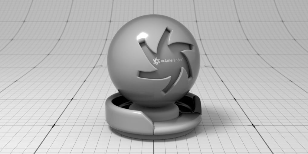

Relative Distance converts the distance to the origin in a specified reference transformation into a greyscale texture.
Relative Distance
Figure 1: Relative distance Node
Relative Distance
Figure 2: A Relative Distance node example
