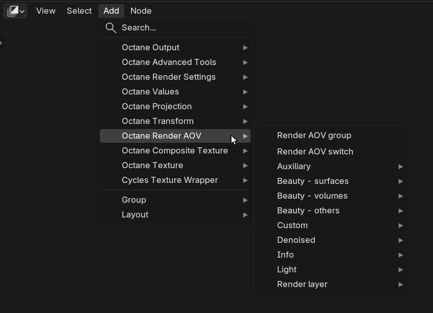

Render Passes or AOVs segregate the different aspects of the scene, rendering each aspect across multiple images. This is useful in fine-tuning projects, compositing, and creating remarkably detailed and photorealistic images. The Octane Render AOVs can then be composited directly in Blender Octane using the Octane Compositor nodes. The Render AOVs are accessible from the Octane Render AOV editor window. Click Add > Octane Render AOV (figure 1).
Render AOVs
Figure 1: Accessing Octane Render AOV Nodes

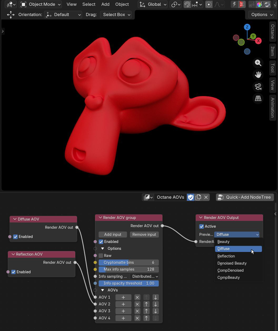

Multiple AOVs can be added using the above method by first selecting Render AOV Group from the AOV list (figure 2). More AOV slots can be added by clicking on the Add Input button.
Render AOV Group
Figure 2: Adding the Render AOV Group node

AOV # - AOV to render out. AOVs can be added using the "+" button on the node or they can be individually added by selecting them from the Octane Render AOV nodes then manually wired to the input.
The Render AOVs can be viewed in the Preview Viewport by selecting their correspinding preview output from the Render AOV Output node (figure 3).
Render AOVs
Figure 3: Viewing the Render AOVs in the Preview Viewport
