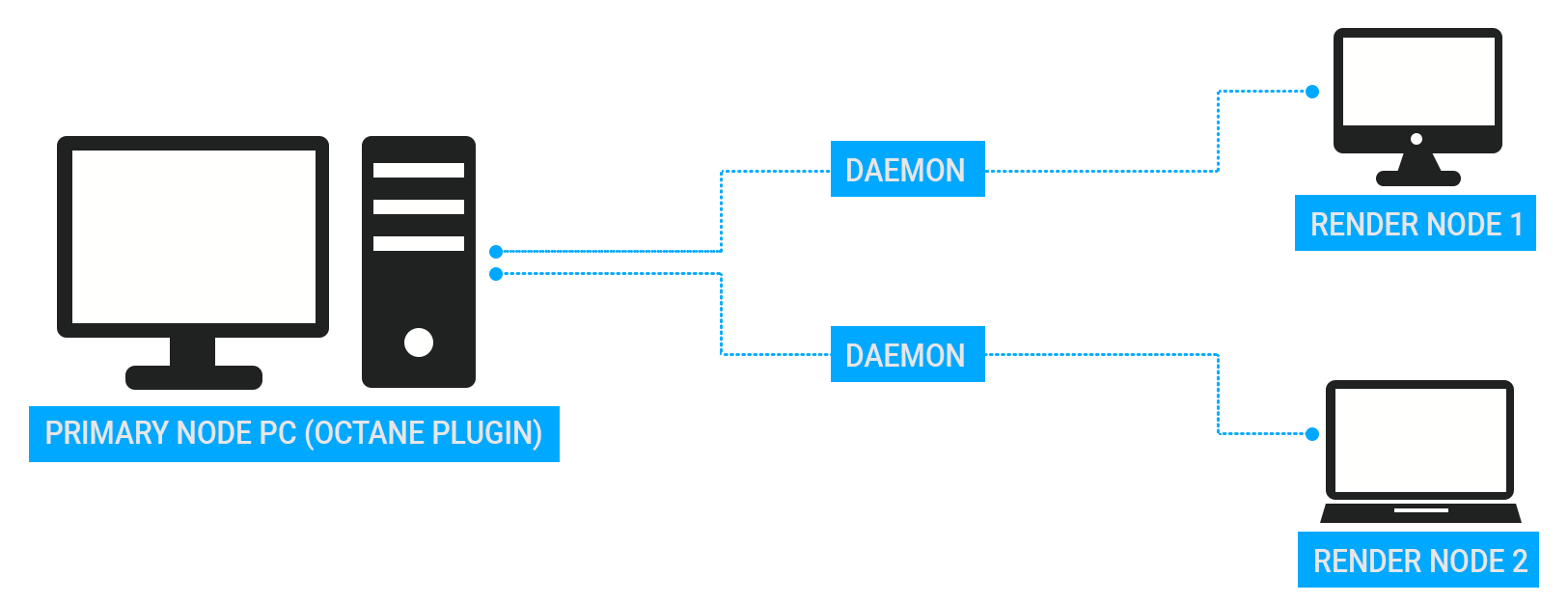

Network rendering allows additional gpus in other computers to be utilized in rendering images. OctaneRender distributes compiled render data and not scene data, so no file management is required by the user. Conceptually it is similar to working with additional GPUs by allowing the distributed rendering of single images over multiple computers connected through a fast local area network. Network rendering requires a Primary Render Node and one or more Render Nodes on different computers. The OctaneRender instance that drives the rendering is referred as the Primary Render Node and the OctaneRender instances that are helping are referred as Render Nodes.
Ensure that the Primary Render Node and the Render Node, respectively, are not blocked by the Operating System firewall or any firewalls in the network. This can be done, for example, by turning off the firewall for home/work networks on the Primary Render Node. If that does not help, also try switching off the firewall on the helper computer for home/work networks.
Primary Render Node, Render Nodes and Daemons
The Primary Render Node is the Blender plugin that runs on the content creation machine. Meanwhile a special console version of OctaneRender, octane_node.exe, runs on other computers as Render Nodes. Running the Render Node on the same computer as the Primary Render Node is pointless.
Render Nodes
Figure 1: The Render Node layout
Unless using Out-Of-Core render features, the Render Node does not need to have a powerful CPU but the it is required to have enough memory to store the render data plus some render results. No data is stored on the Render Nodes’ discs, it all happens 100% in memory. Each time network rendering is required, the Render Node process has to be launched on the Render Node machines. The Render Node Daemon makes the control of the Render Nodes more practical, as the daemon can be set up to be launched at every boot of each Render Node machine in the network. The daemon monitors the Render Node, starts it and stops it on request by a Primary Render Node in the network. Monitoring also means making sure that a running Render Node sends a regular “heartbeat” to the daemon and if that doesn’t happen it will try to stop the Render Node gracefully and if that does not work, it kills the process.
The daemon listens for the “heartbeat” of the Render to check if the Render Node process is still running at all and further eliminates the need to launch the Render Node process manually on each helper machine each time network rendering is required.

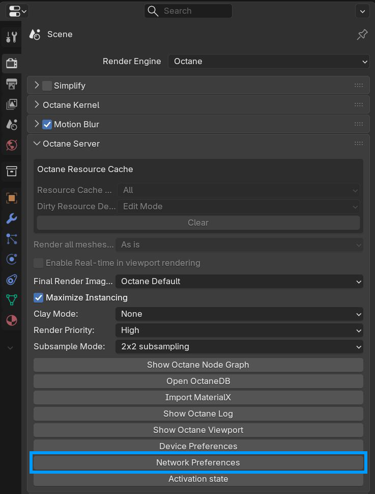

    3. Back at the Primary Render Node, run the Blender Plugin’s OctaneServer if it is not already running. Then navigate to plugin's Network Preferences window through Blender's interface to enable the Network Rendering feature. The Primary Render Node's OctaneServer should be able to pick up the heartbeat of the Render Node sent through the network by the daemon.
Network Preferences
Figure 2: Accessing the Network Preferences
NEtwork Preferences
Figure 2a: Enabling network rendering in the Network Preferences window
While on the Render Node, the Octane Render Node terminal will contain some new lines indicating when the Primary Render Node (Blender Plugin’s OctaneSever component) has picked up this connection. Finally, close Network Preferences window and begin the rendering process.
