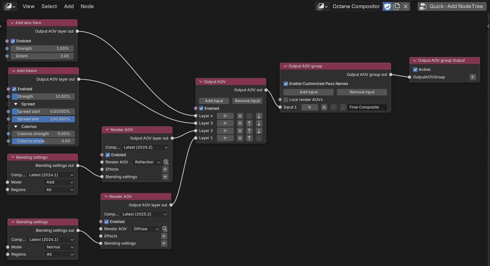

Additional Output AOVs
Many additional Octane Compositor nodes can be used for compositing purposes. Examples are the Add Bloom or Add Glare node. These can be added to an Output AOV node and composited accordingly (usually as the top input on the Output AOV node (figure 1).
Output AOVs
Figure 1: Adding Bloom and Glare to the top of an Output AOV Node Stack
