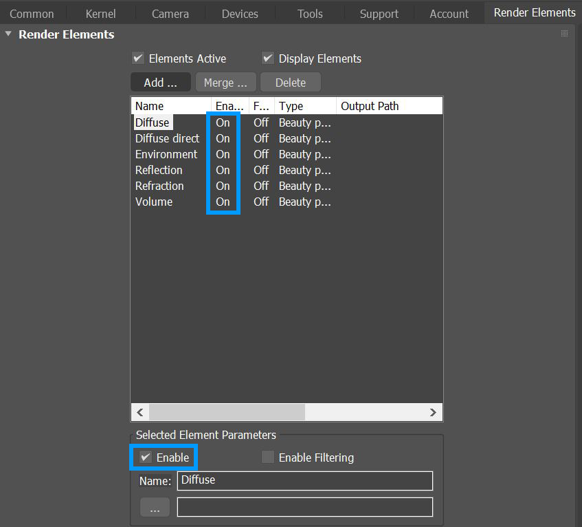

To view and save render passes, go to Rendering > Render Setup > Render Elements and add the passes to include in the render.
Render Elements
Figure 1: Accessing the OctaneRender Render Elements
Make sure that the selected passes are enabled.
Enable
Figure 2: Enabling the Render Elements

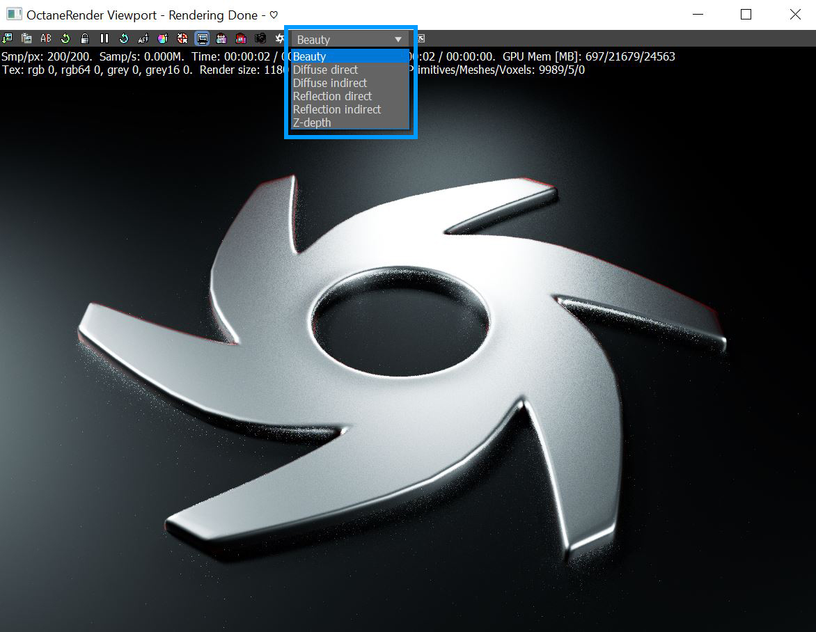

Next, open OctaneRender Viewport and use the Select Multiple Passes button to Import passes selection from Render Elements (figure 4). You can also add or subtract other render passes to the viewport here. Keep in mind for file output renders, you need to make sure you export your passes back to Render Setup > Render Elements. This can be done with the Export Passes Selection to Render Elements.
Import Render Elements
Figure 4: Import Render Elements via the OctaneRender Viewport
Use the Passes Dropbox to select and view each render pass. If you want to save out each pass manually, you can use the Port To Max Framebuffer button.
Viewing Render Elements
Figure 5: Passes Dropbox used to view each pass
