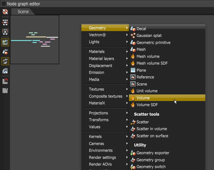

Volume mediums add color and other qualities to a VDB file. VDBs are a generic volume format that create effects such as smoke, fog, vapor, and similar gaseous objects. VDBs are generated and exported from other 3D software programs. You can also download VDB files from www.openvdb.org/download. VDBs can be a single frame, or an animated file sequence. To use a VDB, right-click in the Node Graph Editor and choose Volume from the Geometry context menu (figure 1). Use the file browser to locate the VDB file on your local drive.
Volume Node
Figure 1: Clicking on Volume node
