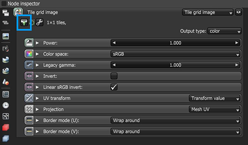

After selecting the Tile Grid Image node, go to the Node Inspector and click on the Load Images icon to select and load images into the grid (figure 1).
Loading Image Tiles
Figure 1: Clicking the Load Images icon from the Image Titles parameters

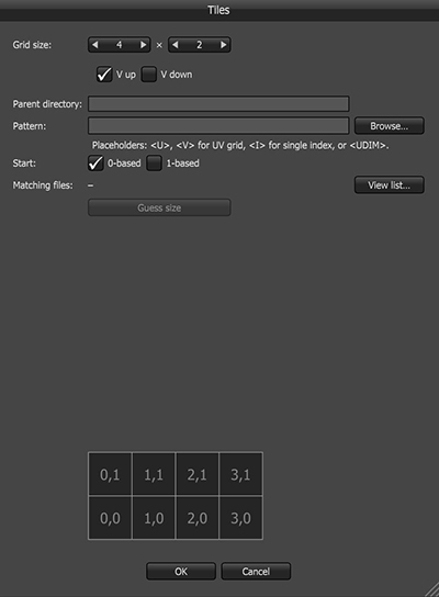

From the Tiles window, adjust the grid's length and width from the Grid Size parameter, then press the Browse button to load the UDIM files (figure2).
Image Tiles
Figure 2: The Image Tiles window
