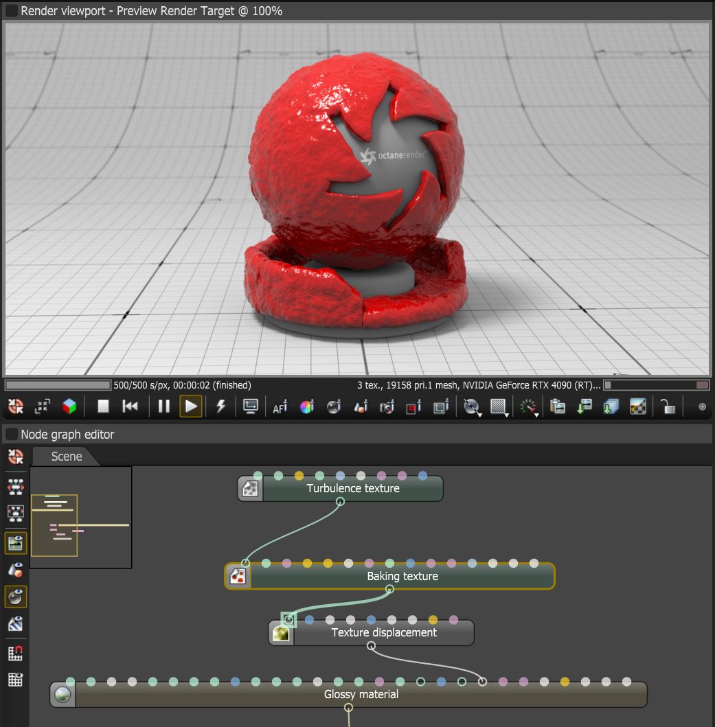

In the following example, displacement uses the Turbulence procedural texture by connecting it to the Baking Texture node before connecting it to the Displacement node (Figure 2).
Baking Texture
Figure 2: The Turbulence node used for Displacement
