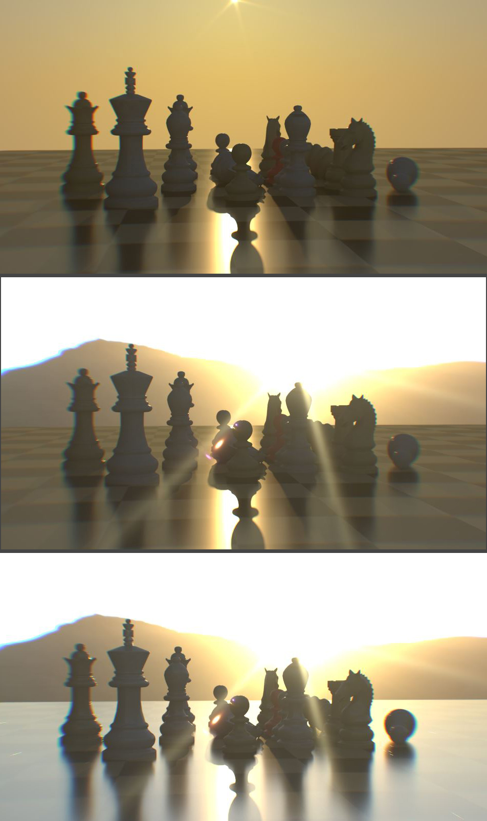

In figure 1, the top image is the Daylight Environment node connected to the Environment pin on a Render Target node. The middle image is a Texture Environment node (using an HDRI) connected to the Visible Environment pin on the same Render Target node along with the Backplate checkbox activated in the Visible Environment node. The bottom image has the Reflections and Refractions checkboxes activated in the Visible Environment node. This combination provides stronger shadows generated from the Daylight Environment node while the background, reflections, and refractions are generated from the Visible Environment node.

Figure 1: Visible environment examples
