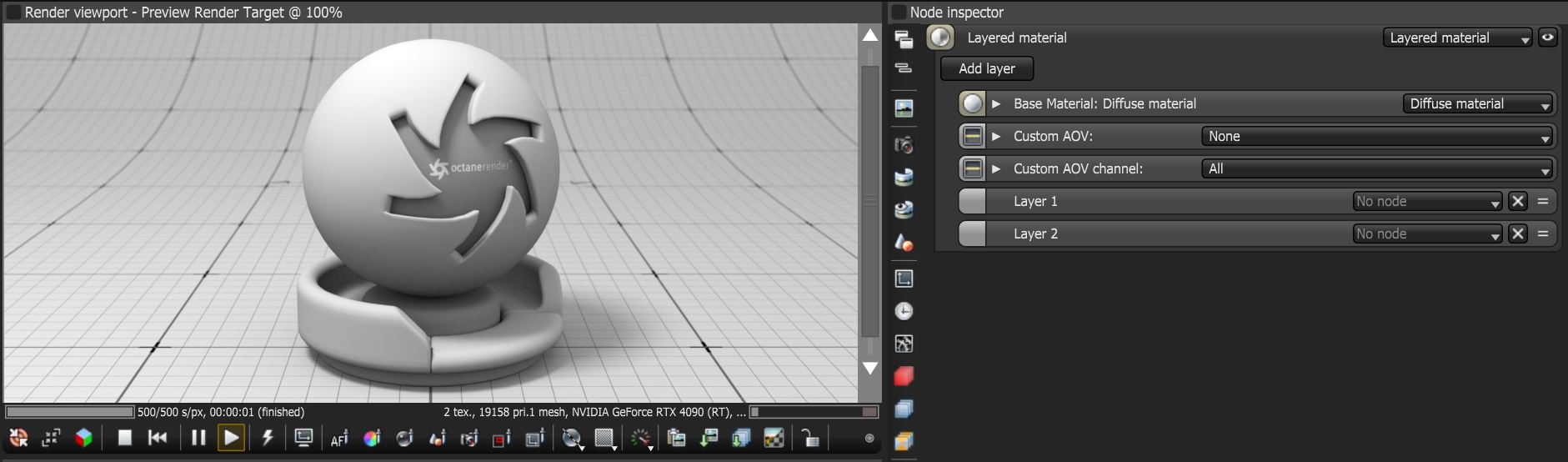

The Layered material node constructs complex materials that consist of a base layer and up to eight Material Layers. You can create complex materials in a physically-based manner, as opposed to manually mixing materials together. By default a Diffuse material is listed as the base material (figure 1). Other materials can be selected as the base material.
Layered Material
Figure 1: Layered material node parameters
