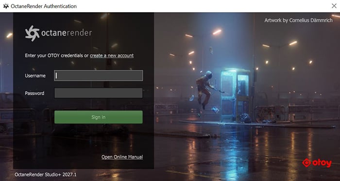

You need an internet connection before starting OctaneRender for the first time in order for it to communicate with the OctaneRender licensing system. When you start the application, this sign-in screen appears.
Activation
Figure 1: OctaneRender Activation window
Enter your OTOY account username and password, then click the Sign in button. At this point, the single sign-on and licensing system pulls a valid license key from your account on OTOY’s secure server.
