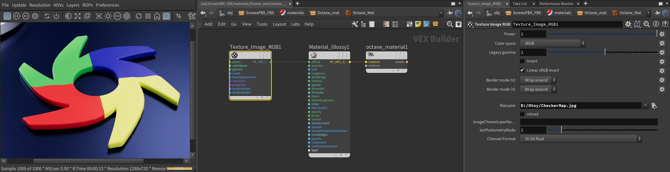

The RGB Image imports external texture maps to any material parameters that accept a texture map (figure 1).
Image RGB
Figure 1: The node network for the material rendering using the Texture Image node
