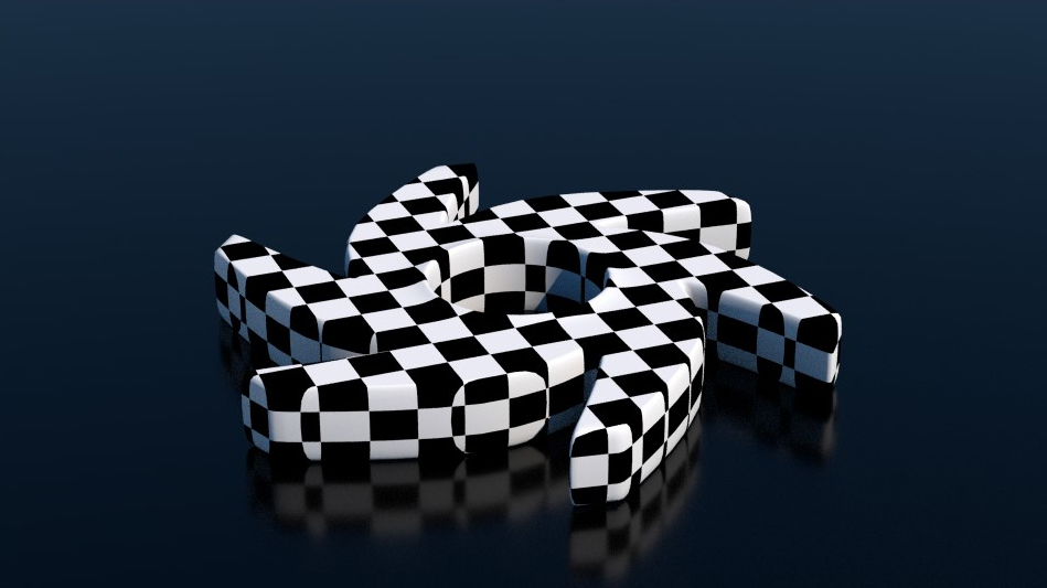

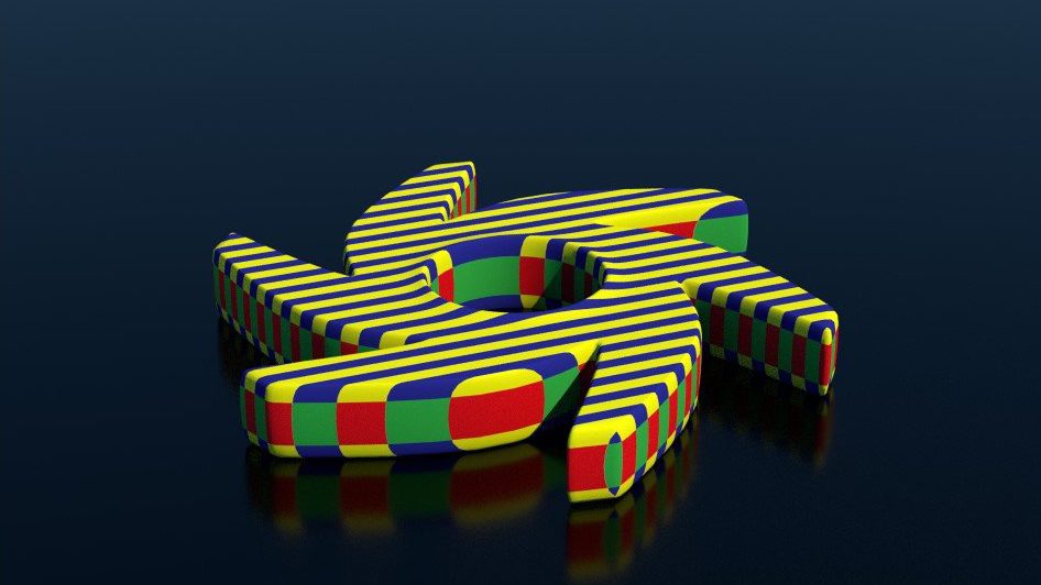

The XYZ To UVW projection is also known as planar projection or flat mapping. This mapping type takes the coordinates in world or object space and uses them as UVW coordinates. For images, only the X and Y coordinates are relevant, which are mapped to U and V. In other words, the images use flat mapping projected along the Z axis. XYZ To UVW results vary, depending on whether it is applied to a Procedural texture or an imported texture. In Figure 1, a procedural texture using XYZ To UVW is oriented in a similar fashion to Box projection. In Figure 2, an imported texture using XYZ To UVW is oriented in a planar fashion.
XYZ to UVW
Figure 1: Octane VOP Network example
XYZ to UVW
Figure 2: UVW projection sampling existing UV mapping data on a sphere with UV planar geometry
