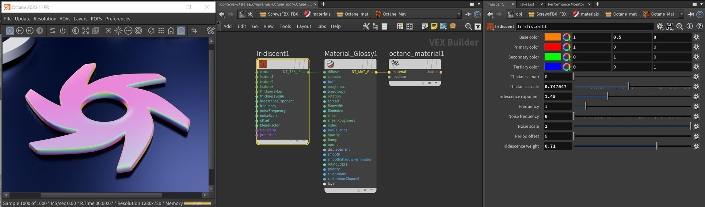

The Iridescent texture node produces an effect where surfaces appear to gradually change color as the angle and illumination of view changes (figure 1).
Iridescent
Figure 1: The Iridescent node and it's associated parameters
