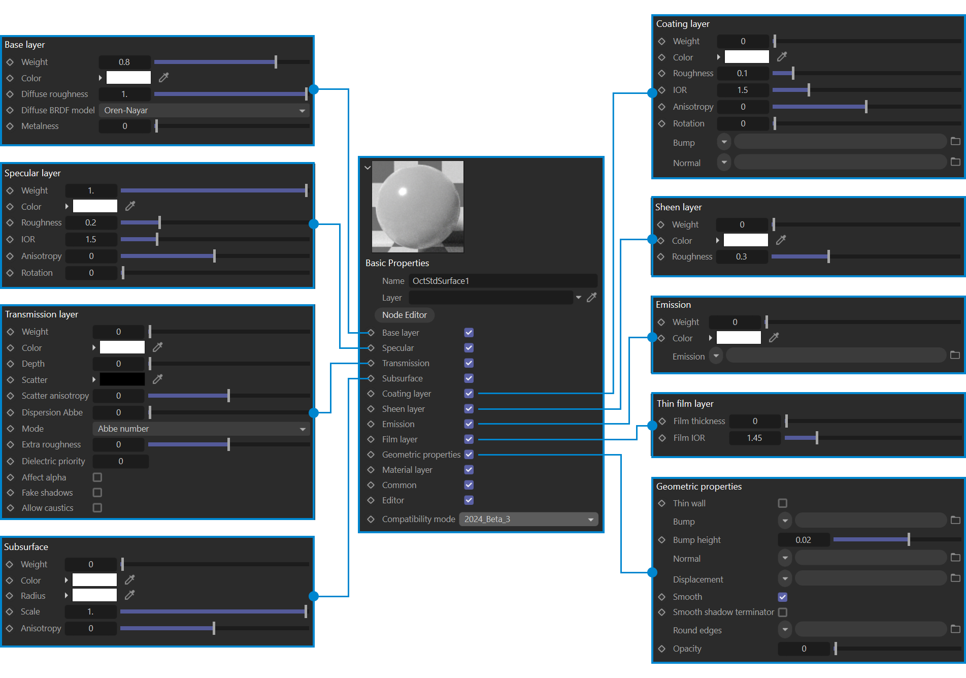

Standard Surface
Standard Surface Components
In addition to the Layered mixture model, we have updated the implementation of individual layers to support the Standard Surface specification:
    • Oren Nayar BRDF
    • Textured anisotropy
    • Specular boundary SSS layer
    • Diffuse boundary SSS layer
    • Reparameterization of material inputs

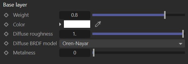

Base Layer
Base Layer
Base Weight — Contribution of the base layer.
Base Color — Color of the base layer.
Diffuse Roughness — Diffuse roughness to allow simulation of very rough surfaces like sand or clay.
Diffuse BRDF Model — Choose from one of the three supported models:
    • Octane
    • Lambertian
    • Oren-Nayar
Metalness — The metallic-ness of the material, blends between dielectric and metallic.

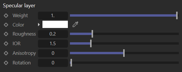

Specular Layer
sPECULAR Layer
Weight — Contribution of the Specular layer.
Color — The Specular reflection channel determines the color of the glossy reflection for dielectric materials. If the Index of Refraction (IOR) is set to a value greater than 0, then the brightness of this color is adjusted so it matches the Fresnel equations.
Roughness — Roughness of the specular reflection and transmission channel.
IOR — Index of refraction control the Fresnel effect of the Specular reflection or transmission.
Anisotropy — The anisotropy of the specular and transmissive material, -1 is horizontal and 1 is vertical. 0.0 is isotropic.
Rotation — Rotation of the anisotropic specular reflection and transmission channel.

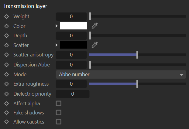

Transmission Layer
TRANSMISSION Layer
Weight — Transmission weight controlling the contribution of light passing the surface of the material (via refraction).
Color — Transmission color tint for refraction.
Depth — The distance travelled inside the material by white light before its color become transmission color by beer's law, if it is zero then transmission color is applied constantly as it crosses boundary.
Scatter — Scattering coefficient of the interior medium.
Scatter Anisotropy — The anisotropy of the Henyey-Greenstein phase function of the interior medium ranging between -1 and 1.
Dispersion Abbe — The dispersion Abbe number, describing how much the index of refraction varies across wavelengths.
Mode — Choose from the following options:
    • Abbe Number
    • Cauchy Formula
Extra Roughness — Additional (positive or negative) roughness on top of specular layer roughness.
Dielectric Priority — The material priority for this surface material.
Affect Alpha — Enable to have refractions affect the alpha channel.
Fake Shadows — If enabled, light will be traced directly through the material during the shadow calculation, ignoring refraction.
Allow Caustics — If enabled, the photon tracing kernel will create caustics for light reflecting or transmitting through this object.

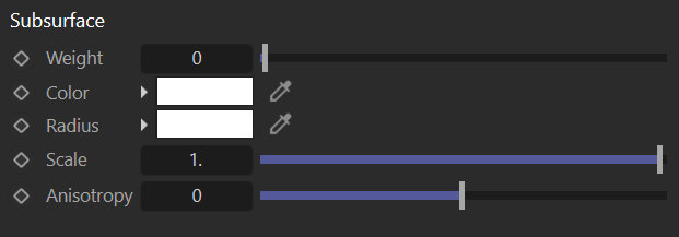

Subsurface Layer
SUBSURFACE Layer
Weight — Contribution of diffuse transmission.
Color — Color used for subsurface scattering.
Radius — Subsurface radii (i.e. mean free paths) of the red, green, and blue channel.
Scale — Scalar scale for subsurface radius.
Anisotropy — Anisotropy of the subsurface medium phase function, ranging between -1 and 1.

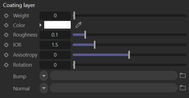

Coating Layer
COATING Layer
Weight — Reflection weight of the coating layer (reflection color is fixed to white).
Color — Tint color for the light coming from all layers below.
Roughness — Roughness of the coating layer.
IOR — Roughness of the coating layer.
Anisotropy — Roughness of the coating layer.
Rotation — Rotation of the anisotropic coating reflection.
Bump — The bump map for coating layer:
1. When not specified, the coating layer uses default shading normal.
2. When specified, it applies bumped/normal mapped surface to the coating layer.
Normal — The normal map for coating layer:

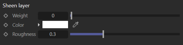

Sheen Layer
SHEEN Layer
Weight — The contribution of sheen layer.
Color — The sheen color of the material.
Roughness — Roughness of the sheen channel.

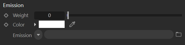

Emission Layer
eMISSION Layer
Weight — The scale multiplier for emission.
Color — The emission color.
Emission — Octane emission channel.

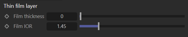

Thin Film Layer
tHIN fILM Layer
Film Thickness — Thickness of the film coating in nanometers.
Film IOR — Index of refraction of the film coating.

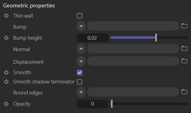

Geometric Properties
gEOMETRIC pROPERTIES Layer
Thin Wall — The geometry the material attached is a one sided planar, so the ray bounce exits the material immediately rather than entering the medium.
Bump — Bump channel to simulate a relief using a grayscale texture interpreted as height map.
Bump Height — Determines the height represented by a normalized value of 1.0 in the bump texture. A value of 0 disables the bump map and a negative value will invert the bump map
Normal — Normal channel to distort normals using an RGB image.
Displacement — Displacement channel to create highly detailed geometry with a low memory footprint.
Smooth — If disabled normal interpolation will be disabled and triangle meshes will appear "faceted".
Smooth Shadow Terminator — If enabled self-intersecting shadow terminator for low polygon is smoothed according to the polygon's curvature.
Round Edges — Smooth sharp edges during render time.
Opacity — Opacity channel controlling the transparency of the material via grayscale texture.

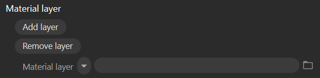

Material Layer
mATERIAL Layer
Material Layer — Material layer above this base material.
