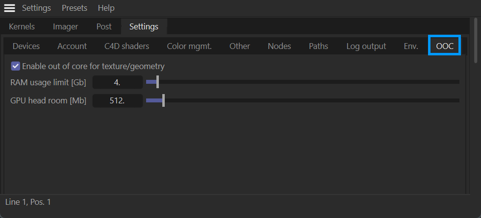

live viewer — out of core tab
Enable Out of Core Textures/Geometry
Enable/disable the use of out of core for textures and geometry.
RAM Usage Limit(GB)
This option allows you to set the amount of out of core RAM to be used in your system. Remember that the value you enter here will no longer be available to the system or other applications.
GPU Headroom (MB)
Determines the amount of GPU memory to leave free on each graphics card when storing image textures or geometry data. VRAM is faster than RAM, therefore GPU Head Room tends to be set to a minimal level since it is practical to have the maximum amount of texture and geometry data fitted into VRAM. Default setting recommended.
