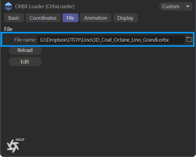

The ORBX Loader requires manually loading the desired ORBX file into the ORBX object itself, as shown in the illustration below. To load an ORBX file, select the ORBXLoader object in the Object Manager. Then, in the Attribute Manager, select the File tab and add in the ORBX file via the file dialog that appears when the ellipsis button is selected.

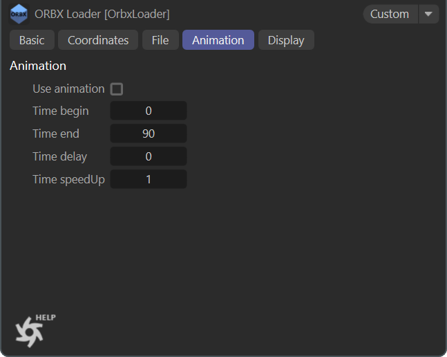

A recent addition to ORBX support in the Octane plugin for Cinema 4D is the ability to have animated ORBX content. When an ORBX file contains animation, that information will appear in the Animation tab. This tab offers the ability to use or ignore the animation in the ORBX file, as well as determine how much of the animation will be used when rendering. In addition, the start time of the animation can be delayed, and the speed of the animation can be adjusted. The image below shows the Animation tab along with the default values.

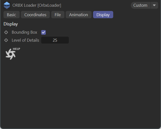

Once the ORBX file is loaded, you will see bounding boxes or vertices drawn in the 3D view windows, depending upon the settings in the Display tab. These bounding boxes represent discreet objects as defined in the in the ORBX file. If the ORBX file had previously been created in Cinema 4D, these bounding boxes would equate to individual objects as listed in the object manager. To see more detail, activate the Display tab of the ORBX Object and disable the Bounding box toggle, as shown in the illustration below.
orbx loader — display tab
When the Bounding box toggle is disabled, object vertices are drawn instead, controlled by the Level of Details edit box. A value of 0 will show the minimum number of vertices. A value of 100 will show all of vertices in the loaded ORBX object.
NOTE In some cases, it is possible that nothing will display in the 3D Views, regardless of the settings in the ORBX Loader object. This means that no discreet objects are defined in the ORBX file, or no polygonal data is in the file itself. This will occur with Vectron objects, for example, as there is no polygonal data contained within that data type. This can also be true with data originating outside of Cinema 4D. |
