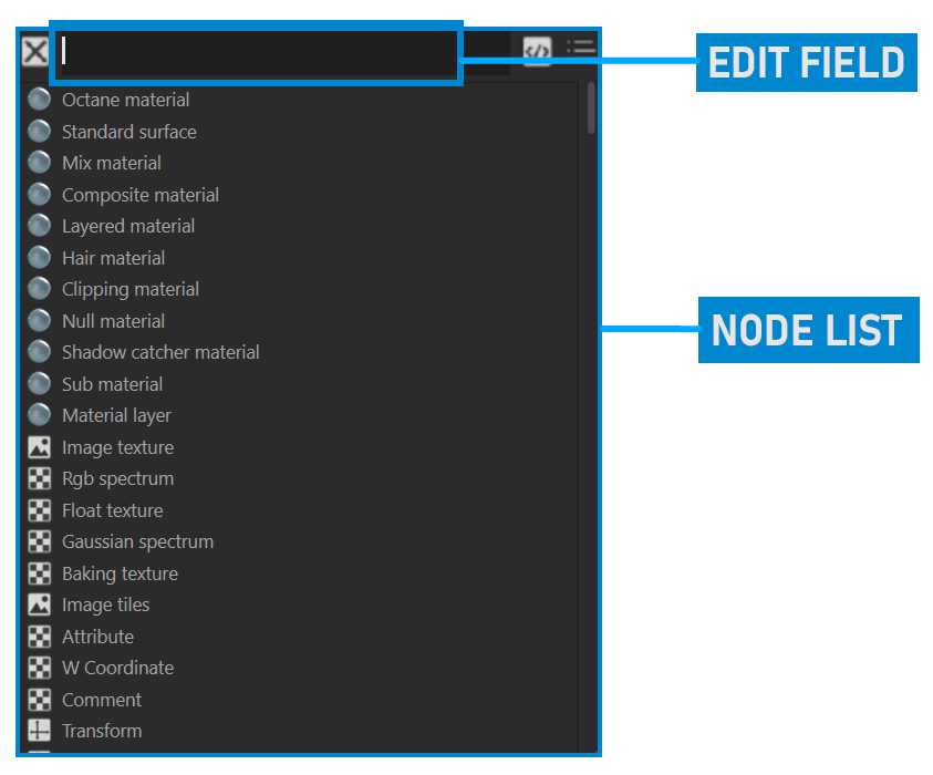

- Click and drag out from any Octane node pin in the Node Editor, and the Search Window will appear:
node search window
Note that the Search window is populated with acceptable node connections for the initial pin that may have been selected upon activation of the Search window. You can also type in any value in the edit field at the top of the panel, though only relevant inputs will be accepted. Double-click the desired node from the node list and that node will then be created in the Node Editor. If a node pin was selected when the Search Window was activated, the node will be automatically connected to that pin. Once the node is created, the Search window will close.
