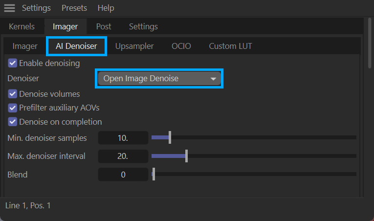

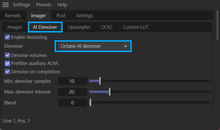

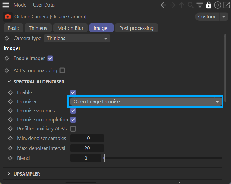

    1. Go to Live Viewer > Octane Settings > Camera Imager tab > Denoiser tab and check Enable Denoising. Choose which Denoiser will be enabled.
camera tab — Spectral ai denoiser
camera tab — Open Image denoiser

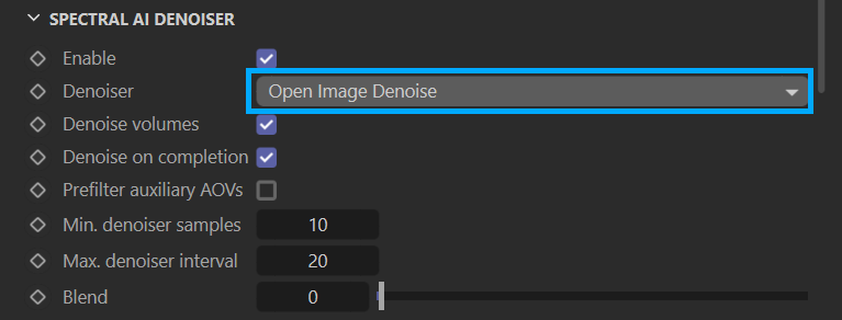

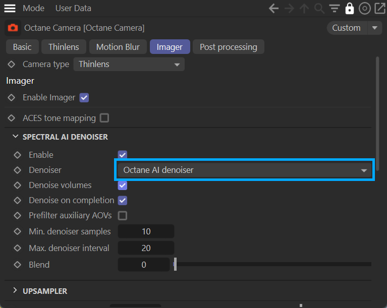

    1. Go to the Octane Camera tag > Camera Imager tab > Spectral AI Denoiser group and Enable.
octane camera tag — Spectral ai denoiser
octane camera tag — Open Image denoiser

    1. Enable the AI Denoiser so that Octane will use it for the render. This can be accomplished either via the Live Viewer (Live Viewer > Settings > Camera Imager > AI Denoiser tab) or Octane Camera tag (OctaneCamera tag > Camera Imager > Spectral AI Denoiser and Enable the Camera Imager.) Choose the desired denoiser to use.
Enable denoiser

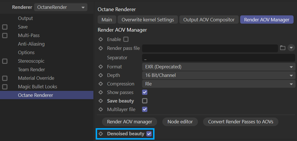

    1. Enter Render settings (CTRL + B) and go to Render Settings > Octane Renderer > Render AOV Manager tab. Enable Denoised Beauty. If a standard Beauty pass is also desired, enable it here. If Volumetrics are present in the scene. Enable "Denoised Volume" if needed.
render settings — render aov manager — ai denoiser

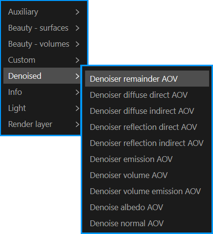

    1. Separately, various denoised AOV passes can be activated by choosing the desired AOV output from Render Settings > Octane Renderer > Render AOV Manager> Render AOVs turndown and press the Add Render AOV button, which reveals this menu:
OPEN IMAGE DENOISER NODE OPTION
In general, even if a desired output or AOV pass is not directly available as a denoised pass, these outputs can be denoised with the Open Image Denoiser node via the AOV Compositor.
