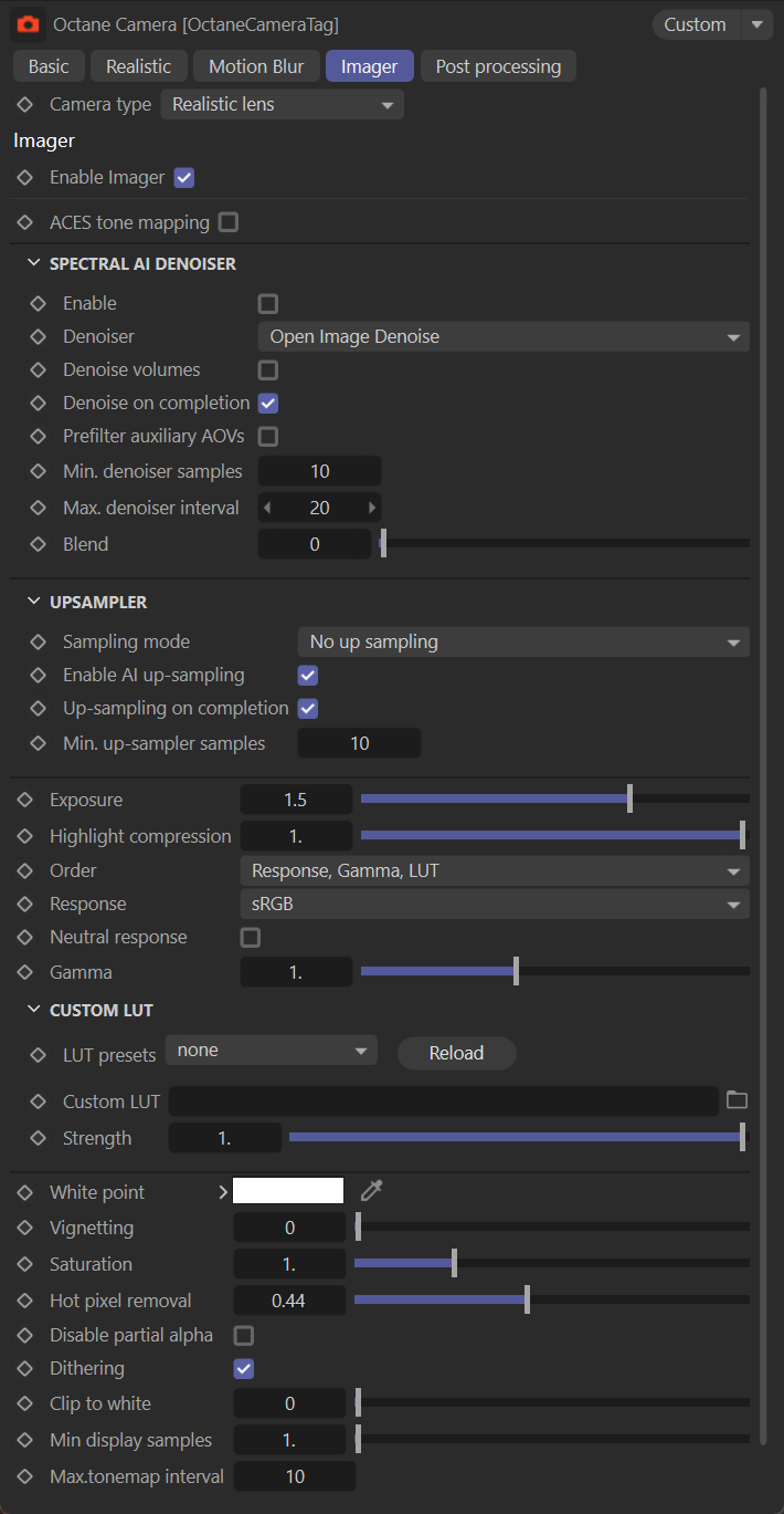

The Octane Camera > Camera Imager tab is used to control the output behavior of the Octane Camera when rendering frames (exposure, camera response curve, gamma, LUT, white point and so on) as well as choosing the camera type.
camera imager tab
Enable Camera Imager
Used to enable or disable the camera imager. If the camera imager is disabled, the settings from Live Viewer are used instead.

Spectral AI Denoiser
The Spectral AI Denoiser lets you render noise-free images with the Path Tracing kernel in short amount of the time. The denoiser is not trained for the PMC kernel. With the denoiser’s tiling and multi-GPU support, the OctaneRender® engine can denoise any resolution up to OctaneRender’s maximum while consuming about 450 MB per device.
The denoiser is trained to denoise volumes and volume passes. Volumetric passes have very low frequency details, so don't use the Volumetric AI Denoiser with less than 1000 samples if you want to preserve details for final render quality that would resemble a 2K to 10K sample render of the scene.
Enable
Enables the Spectral AI Denoiser, which denoises some beauty passes - including the main beauty pass - and writes the outputs into separate render passes.
denoiser
This option allows the choice of either the original Octane AI Denoiser or the Open Image Denoiser.
Denoise Volumes
If enabled, the Spectral AI Denoiser denoises volumes in the scene. Otherwise, volumes are not denoised by default.
Denoise on Completion
If Enabled, beauty passes are denoised once at the end of a render. Disable this option if you're rendering with an interactive region.
Min. Denoiser Samples
The minimum number of samples per pixel until the denoiser kicks in. This is only valid when Denoise On Completion is disabled.

Up-sampler
OctaneRender® includes a built-in AI upsampler in the Camera Imager. When specifying an Upsampler Mode, the AI upsampler performs a faster render at a lower resolution, then upscales to the final resolution. The AI Upsampler also has progressive and one-stop upsampling modes, similar to the AI denoiser.
Sampling Mode
Selects the upsampler mode for rendering. The image renders at a lower resolution divided by the sampling mode, then it upscales to the final resolution.
Enable AI Up-sampling
When you have an Upsampler Mode selection made and you have this option enabled, the render scales using AI upsampling. Otherwise, scaling is done using traditional methods.
Up-sampling on Completion
Beauty passes upsample once at the end of a render.
Min. Up-sampler Samples
The minimum number of samples per pixel until the upsampler activates. This parameter doesn't apply if you select No Upsampling in Upsampler Mode.

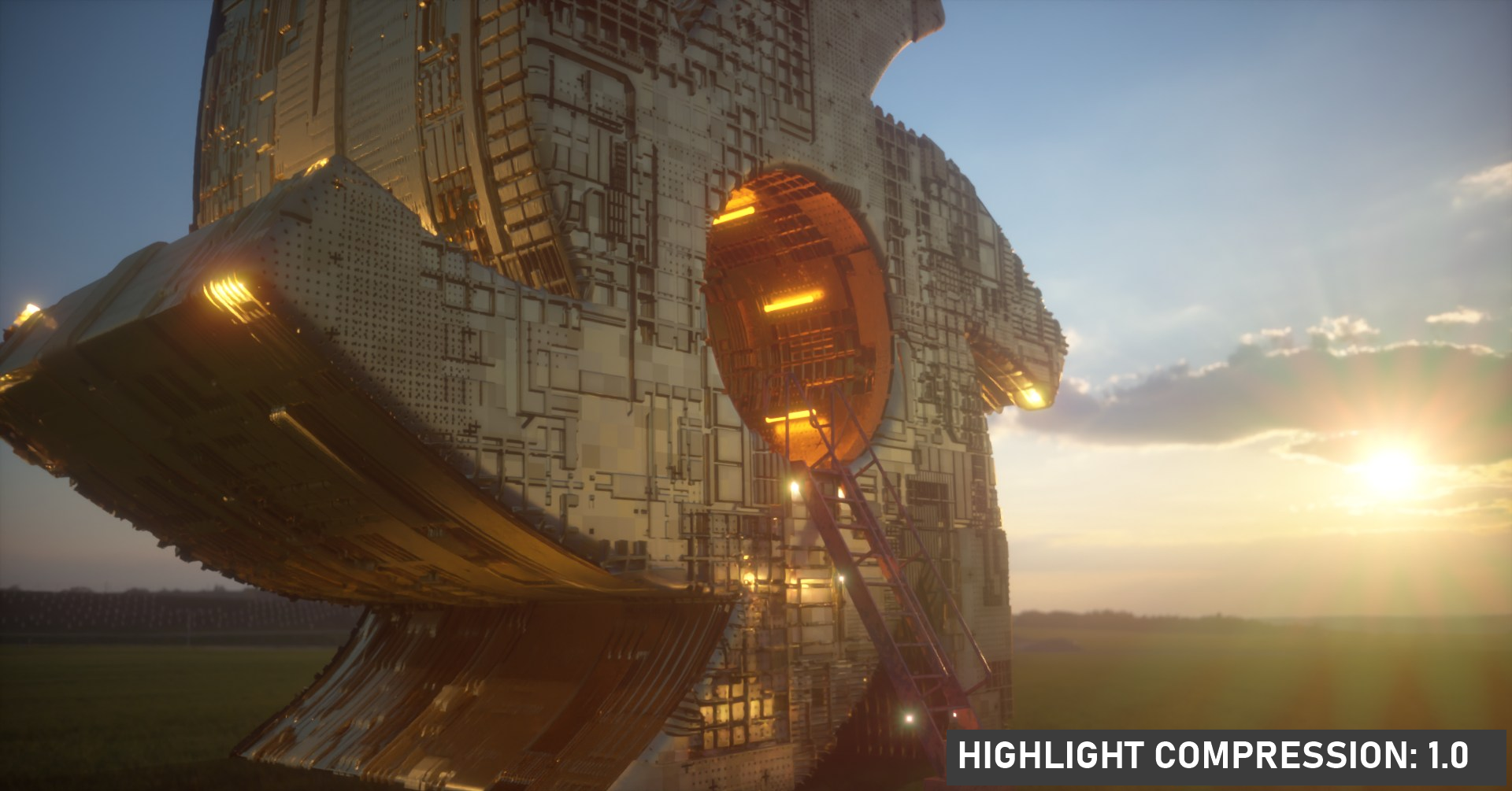

Highlight Compression
This reduces burned out highlights by compressing them and reducing their contrast. If some scenes have more exposure, this option can compensate for excessive brightness.
highlight compression

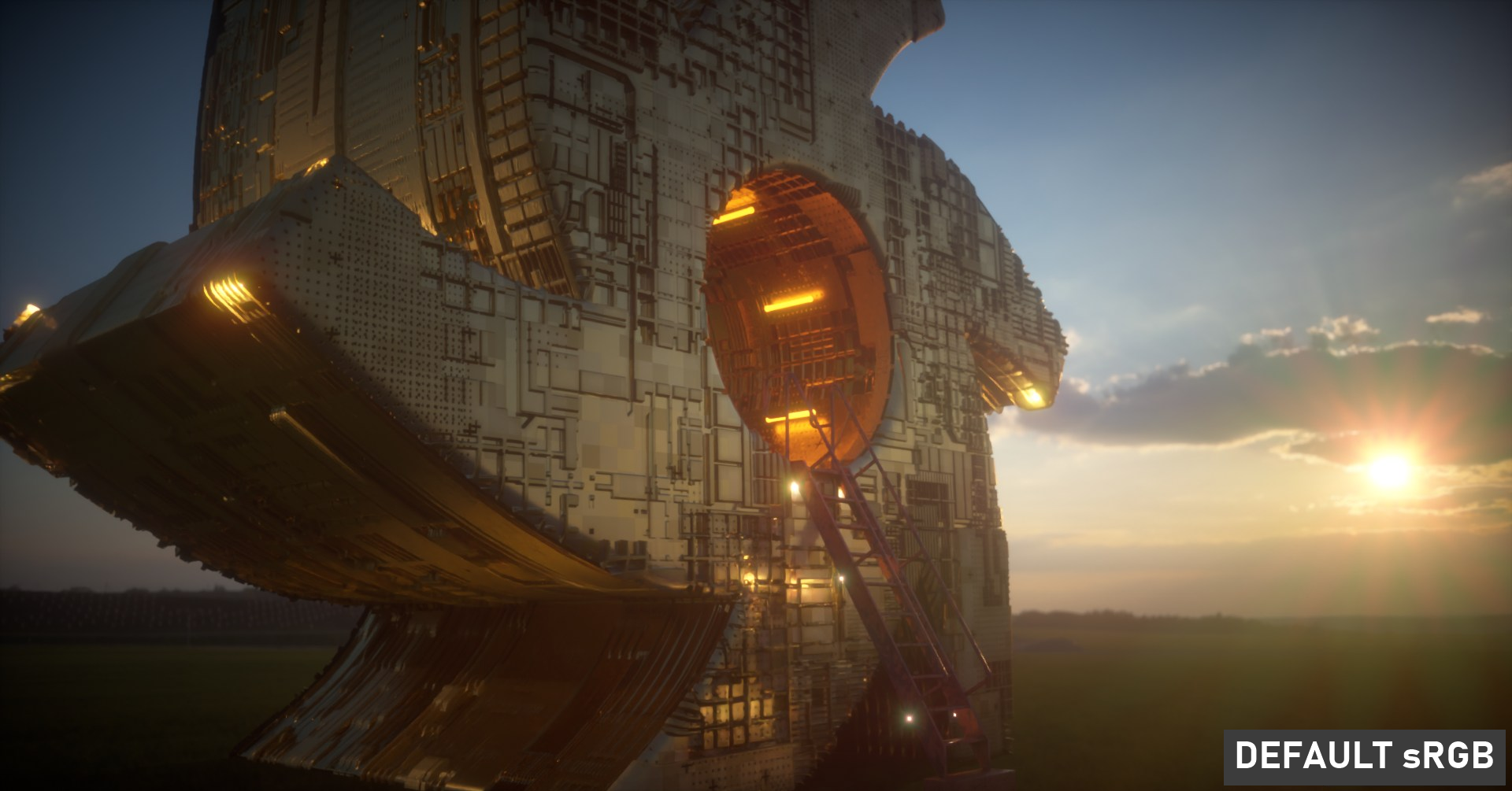

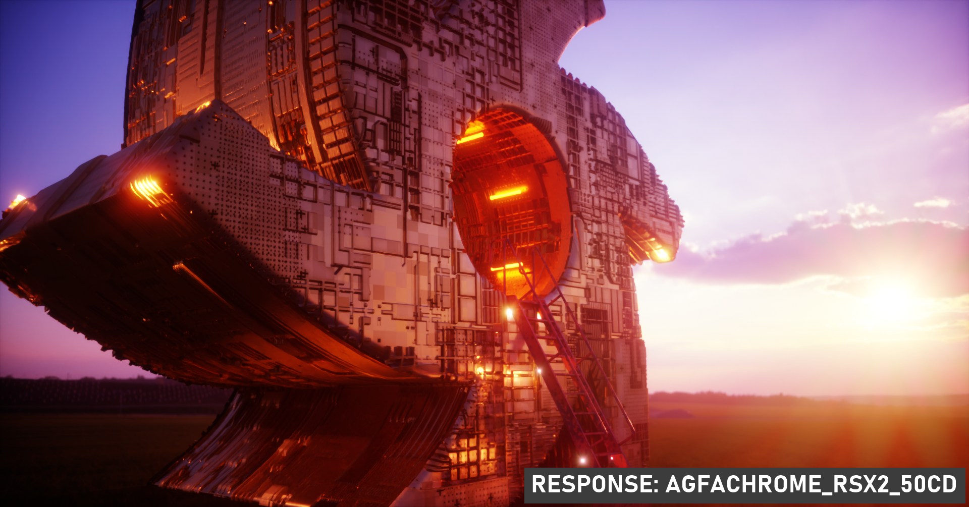

Response Curve
Measured camera response curves can be selected from here. You can take advantage of a number of response options for the render output and see them instantly in the Live Viewer. In fact, you "may" not even need to use the 3rd party compositing tool. Octane also has response curves that reproduces the rendering neutrally on a normal display. The “sRGB", "Gamma 2.2" and "Gamma 1.8" are applicable for most displays that either use sRGB or simply apply a gamma of 2.2 or 1.8. To see examples of response curves, go to this link. There is always an option available to you based on the quality of your Render output.

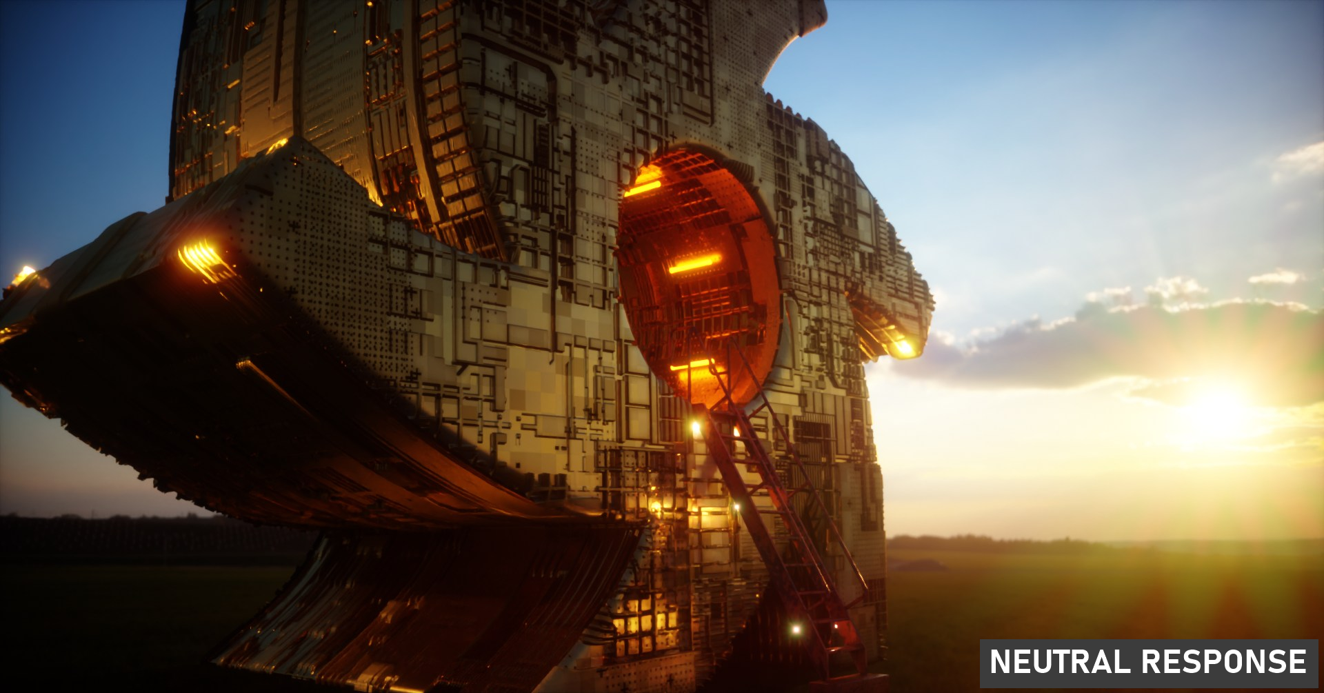

Neutral Response
If enabled, the camera response curve will not tint the rendered result.
neutral response

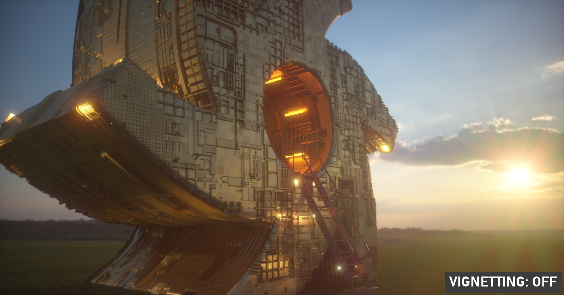

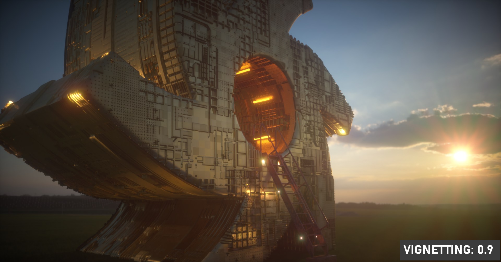

Vignetting
Adjusting this parameter increases the amount of darkening in the corners of the render. Used sparingly, it can greatly increase the realism of the render.
vignetting
