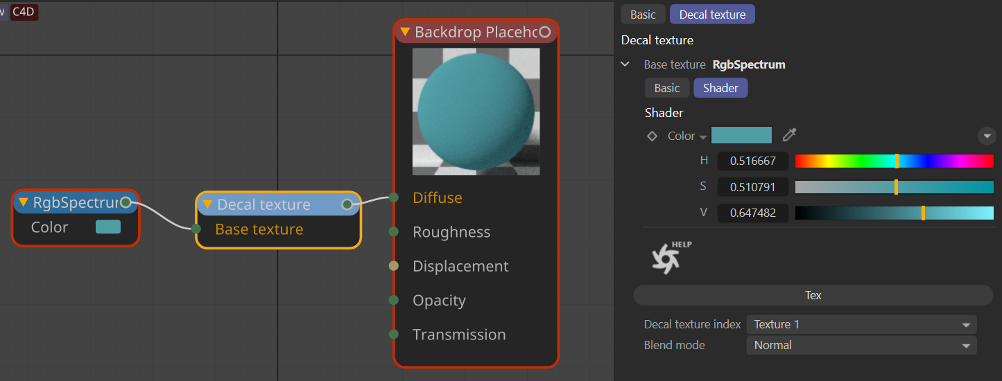

Decals work by overriding a specific channel of a material, so it is necessary to specify which channel (or channels) receives the decal by connecting a Decal Texture node to the appropriate channel, as shown in the following image:
The Decal Texture node is found in the Octane Node Editor in the Utils tab (it can be faster to access with the Find command in the Node Editor.) In this case, the Decal Texture node is connected to the Diffuse input of the material. The following image shows the result:
Decal Texture Index
The Decal Texture Index determines which decal texture level drives the material channel using the Decal Texture node input.

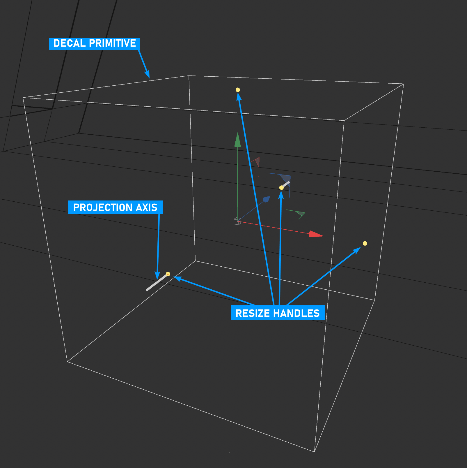

The Octane Decal Object is spatial and uses a cube primitive in the 3D scene for precise decal positioning onto the object. This primitive can be rotated, positioned and scaled, like any other Cinema 4D primitive. The Decal is projected along the Z (blue) axis, and must be oriented properly in order for the decal to appear as expected.

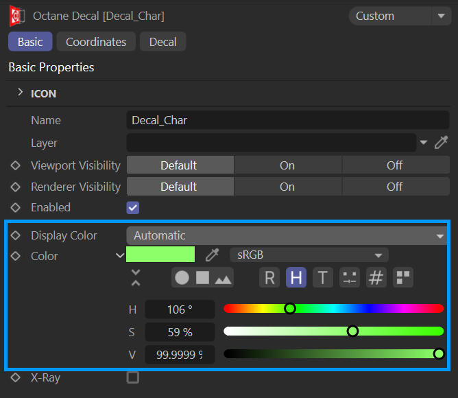

The Decal Object can be colored as needed, which can be very helpful in complex scenes. To do so, select the Decal Object in the Object Manager. In the Attribute panel, choose the desired color operation from the Basic tab > Display Color menu.

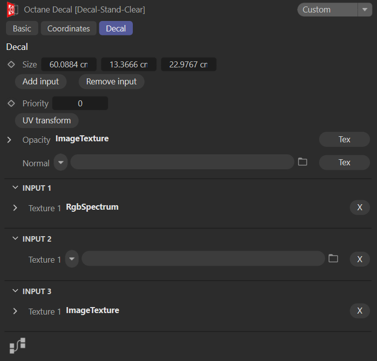

Different decals can be layered into the material by using the materials Material Layer options. As there can be many Decal Objects in a scene, and a Decal Object can contain up to nine actual Decals (plus mask and normal inputs) the desired decal must be referenced. This is done via the Decal Object > Decal Texture tab > Decal Texture index menu. You can also set the Decal Blend Mode in the same tab (choosing between Normal, Add and Reoriented Normal Map).

Each decal has it's own Priority value, from 0 to 10, with 10 being the most. The Priority value is found in Decal Object > Decal tab >Priority. This can help to resolve stacking order issues.

The Octane Decal Object — add desired textures into the same Texture Input. Texture input is referenced by the Decal Texture node. Each Texture Input can have up to nine separate textures.
