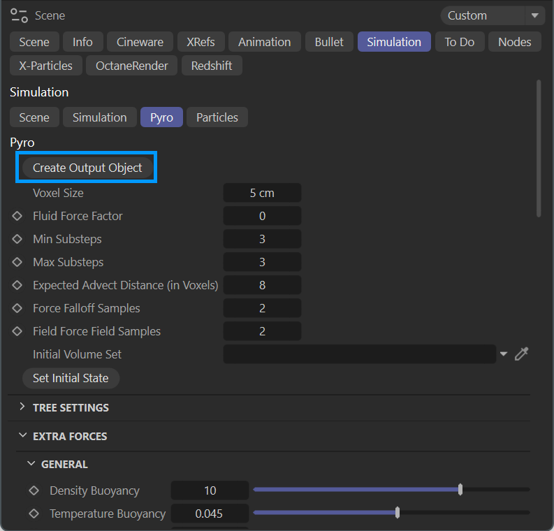

Add the Pyro Simulation output object into the scene
The Pyro Simulation Output Object needs to be added to the scene. Choose Project Settings > Simulation tab > Pyro tab and click on the Create Output Object button. This will add the Pyro Output (Default) object into the Cinema 4D Object Manager.
add the pyro simulation output object

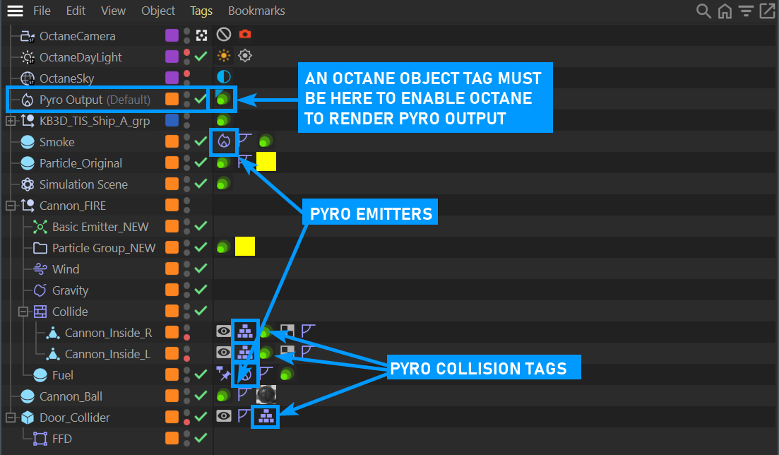

Select the Pyro Output (Default) object in the Object Manager. In the Tags menu of the Object Manager, choose Tags > Extensions > OctaneRender > Octane Object Tag to add an Octane Object tag to the Pyro Output object. This tag contains all of the shading information to properly render the Pyro output in Octane.
Pyro Output and tags in the c4d object manager

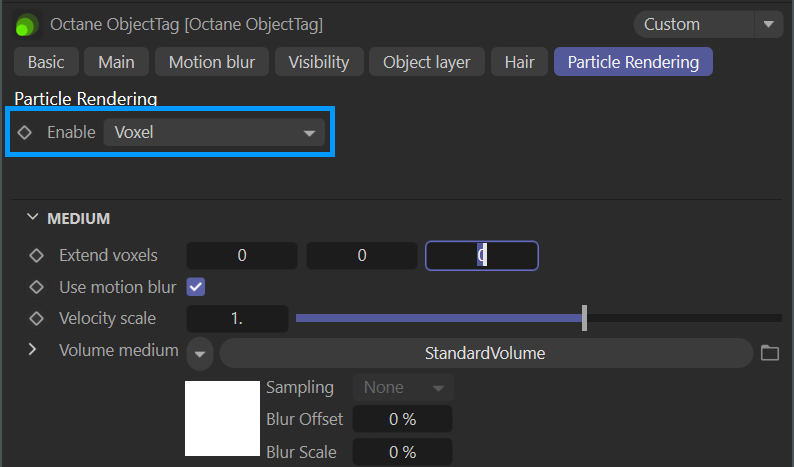

Set up the Octane Object Tag
As noted previously, the Octane Object tag attached to the Pyro Output (Default) object is required to render the Pyro output. Select that tag, and go to the Particle Rendering tab, illustrated below:
octane object tag — particle render tab
Set the Enable menu to Voxel. This will add a Standard Volume Medium to the Volume Medium slot. Now, when setting the following values, you will be able to see the results in Live Viewer.

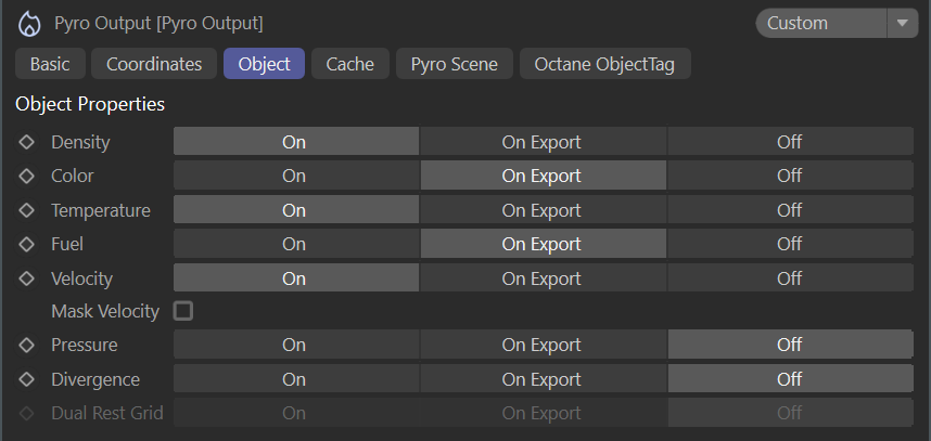

Pyro Output (Default) Object
Select the Pyro Output (Default) object and go to the Object tab. This tab determines what the Pyro object will be including. There are three states to choose from:
    • On — This option enables the specified channel immediately in the viewport and in Live Viewer when working with Pyro on a live basis.
    • On Export — This option will include the channel when the Pyro object is exported as a VDB object. It is exported as a grid. For more information, see here.
    • Off — This option will disable the channel from either live or exported VDB files.
Choose the option you need. To speed up the simulation process as you work, you can enable only the specific channel you are interested in, and enable the others for rendering.
These channels are available to the Standard Volume Medium, by name. You will need to manually type in the name of the channel in the appropriate slot in order for the Standard Volume Medium to act on it. If the channel is not enabled via either the "On" or "On Export" options, yet referenced by the Standard Volume Medium, Octane may ignore the Pyro volume until that error is rectified.
pyro output (default) object

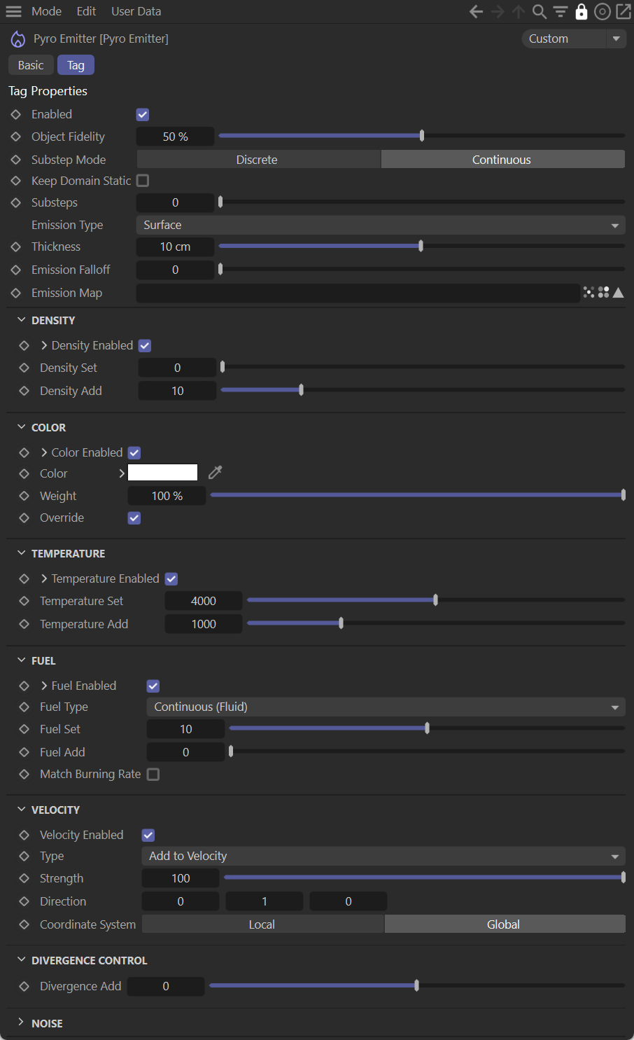

Pyro Emitter/Pyro Fuel Tag
Either one of these tags are attached to any emission source in the scene. Note that channels also need to be enabled in the tag itself in order for the channel to be available to the Standard Volume Medium for rendering. The following illustration shows the Pyro Emitter tag.
pyro emitter tag

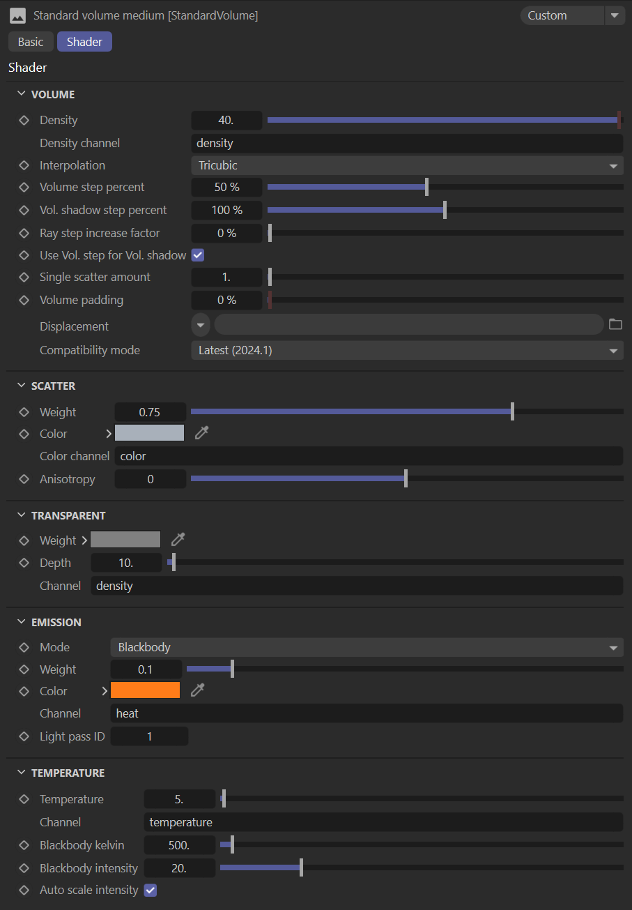

Pyro standard volume Settings
The Standard Volume Medium settings determine the final appearance of the Pyro simulation. Not all channels need to be specified in order to have a visual impact. Play around with different channels in these attributes to find the best look overall.
Note the Auto Scale Intensity can be unpredictable; if used, the results are best if the Black Body Intensity value is low, so as not overdrive the result. The image below shows the settings used for the topic illustration above.
For more information on the Standard Volume, see here.
pyro — standard volume medium settings
