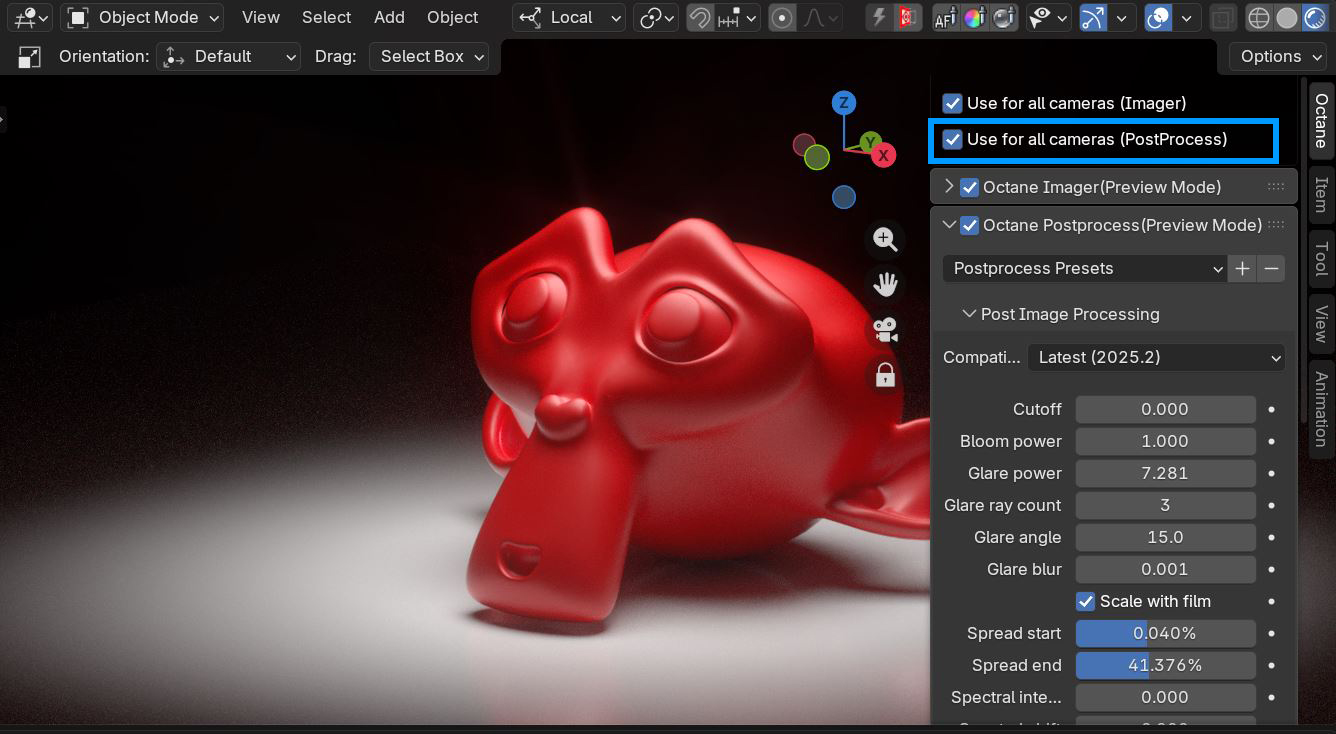

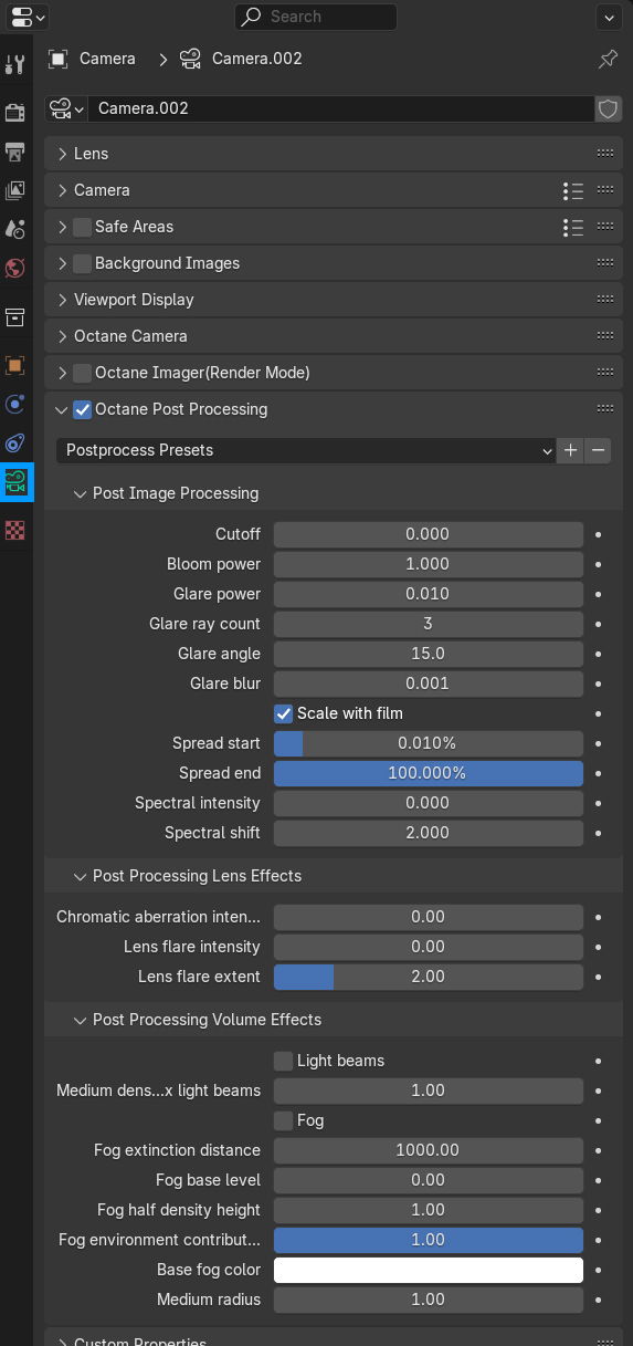

The Post Processing settings are accessible from the Octane Post Processing rollout in the Camera properties tab (figure 2). However, these settings will be disabled if the Use for all Cameras (Post Processing) checkbox is active in the viewort (figure 1). When the Use for all Cameras (Post Processing) checkbox is active which it is by default, the Post Processing settings in the Octane sidebar will control the render.

Figure 1: Use for All Cameras (Post Process) active

Figure 1: Octane Post Processing Parameters
Post Image Processing
Cutoff - Applies bloom/glare to pixel values above the Cutoff value.
Bloom Power - Controls the size of the glow originating from an emitter, the size of the halo of light originating from the sun and/or concentrated light on reflective glossy materials to add a bloom effect to the rendered image.
Glare Power - Controls the size of the visible rays originating from an emitter, the size of the glare originating from reflective glossy materials at a point where concentration of light is at the highest to add a glare effect to the rendered image.
Glare Ray Count - Controls the number of visible rays radiated or reflected.
Glare Angle - This is used to adjust the rotation of the glare relative to the object. A glare angle of -90 and 90 results to one main horizontal glare, and a glare angle of 0 results to one main vertical glare.
Glare Blur - Controls the sharpness of the glare. Smaller values will result to a crisp linear glare and this is softened as the value is adjusted and set higher.
