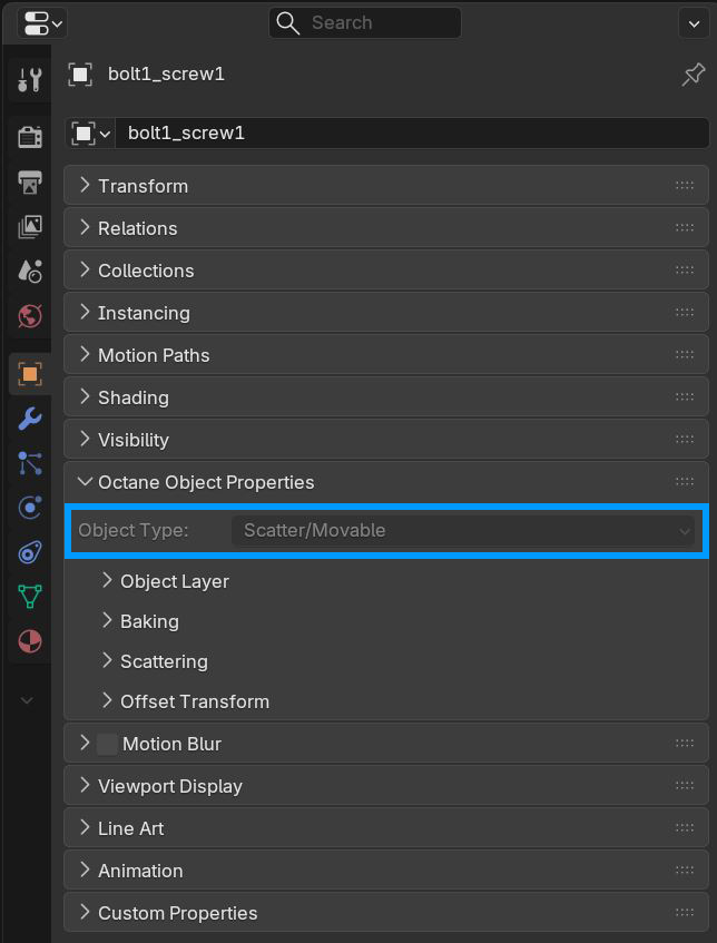

Before you begin rendering a scene, it's important to set the Object Type for the geometry in the scene. By default, it is set to Scatter/Movable (figure 1). Choosing the correct object type is crucial for optimizing render performance, reducing memory usage, and speeding up rendering.
Object Types
Figure 1: Setting the Mesh type in the Object Data window
