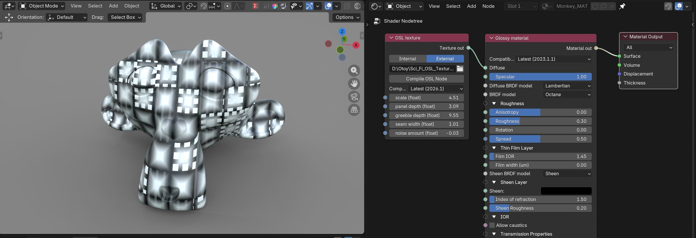

Figure 1: OSL compiled texture generating sci-fi type texture with custom parameters
There are two options to add scripts for the OSL texture. The Internal option is available by opening another area in Blender® for the Text Editor, creating a new text, and writing the OSL script. The External option lets you to select a pre-coded OSL file from the File Explorer window.
The OSL texture requires one output color. One OSL texture node is one OSL compilation unit, which contains only one shader. The OSL texture node has one Output attribute pin that connects to the Texture input pin of other Texture nodes (like Turbulence), or to the Texture input pin of Octane materials (like Diffuse).
