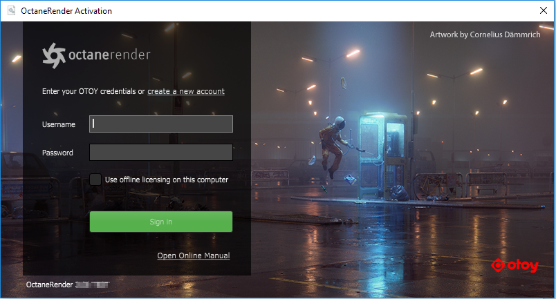

Signing In To The Octane Licensing System
You need an internet connection before starting OctaneRender for the first time in order for it to communicate with the OctaneRender licensing system. When you start the application, this sign-in screen appears.
Signing In
Figure 1: OctaneRender Activation window
Enter your OTOY account username and password, then click the Sign in button. At this point, the single sign-on and licensing system pulls a valid license key from your account on OTOY’s secure server.

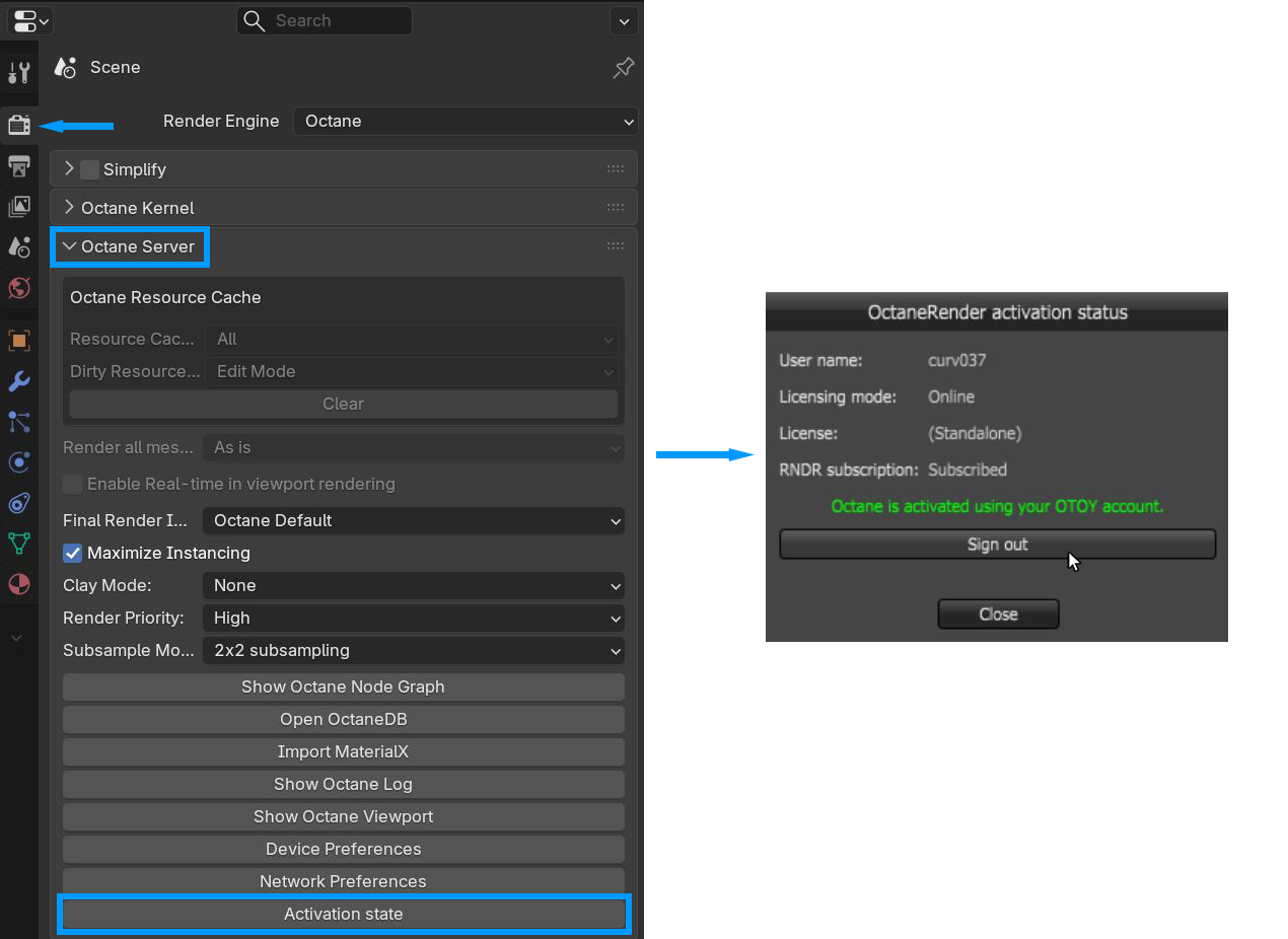

Closing A Session
To close a session, go to the OctaneRender Activation Status window by clicking on Render > Octane Server > Activation State, then click the Sign Out button. This closes the current session and releases all licenses bound to the current machine. If any plugin or another Standalone instance is running at that time, close them before continuing with the sign-out process. Older versions of OctaneRender® that are running releases the licenses too, which deactivates your plugin or Standalone instance.
Signing Out
Figure 2: Signing out
