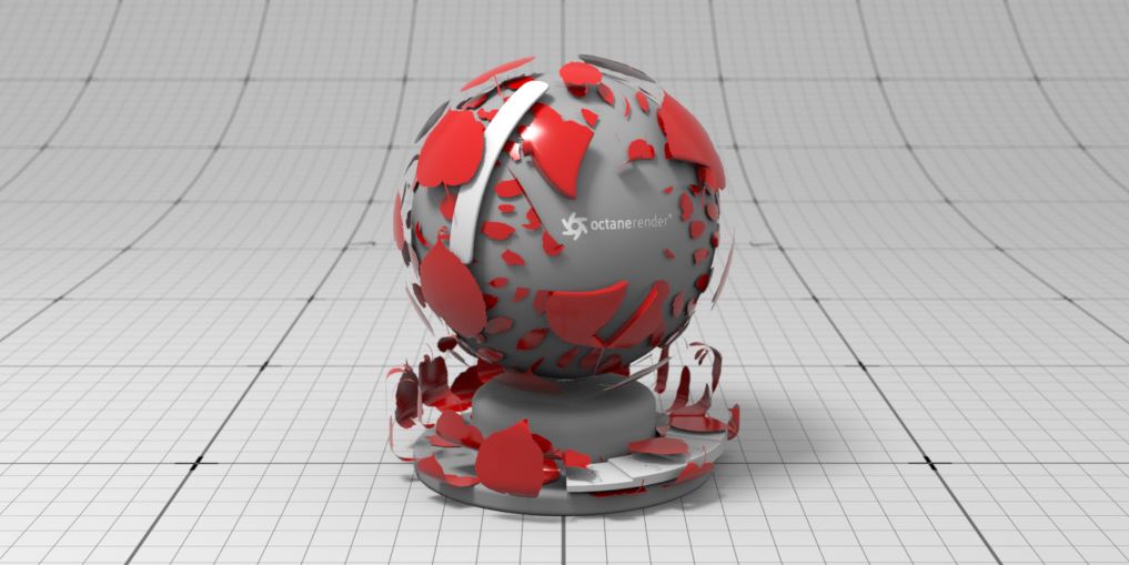

The Alpha Image texture utilizes the image's native alpha channel to provide transparency. This texture only accepts PNG, TIF, and EXR images. It will ignore any information contained in the RGB channels for the texture map and output only the alpha information (Figure 2).
Alpha Image
Figure 1: Alpha image Node
Alpha Image

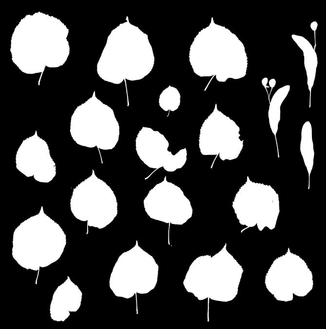

Figure 2: An Alpha Image node connected to the Opacity socket on a Glossy material
Alpha Image
Figure 3: The Alpha Image texture map from figure 2
