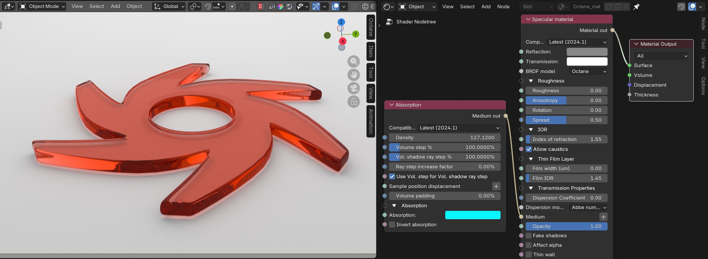

Absorption is controlled with the Absorption medium, which defines how fast light is absorbed while passing through a medium. The absorbed light will not continue through the surface and it's absorbed energy is converted to the opposed color from the color specified in the Absorption attribute (figure 1).
Absorption
Figure 1: The Absorption Medium parameters as seen in the Shader Editor with Invert Absorption deactivated.
The color resulting from the absorption is dependent on the distance light travels through the material. With increased distance, it gets darker, and if the absorption is colored, it becomes more saturated. It works in a subtractive manner in that the scattered color is the compliment of the color designated in the parameter (figure 2).

Absorption can also be controlled using color values. The observed color is the complementary color (opposite color) of the specified color value if Invert Absorption is deactivated (figure 5).

Invert Absorption - Inverts the absorption characteristics so that the absorption color specified is the same color seen in the surface. For example: Red results in red, otherwise, red would result in green (if this check box is inactive).
