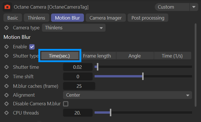

- Time (Sec) — Adjusts the amount of motion blur amount in the rendered frame using frames per second. To enter the real-world shutter values, determine the desired shutter speed with this calculation, as follows: for 30 frames per second, divide 1 into 30; the result is 1/30 = 0.03, and this is the value to enter into the Shutter field, assuming a 360° shutter. For 24 frames per second, do the same math, and the result is 0.04. Divide that by two for a 180° shutter value, which is 0.02.

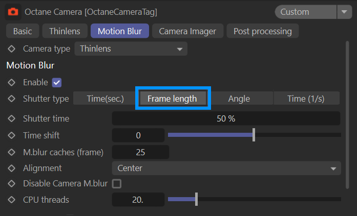

- Frame Length — Determines the amount of motion blur using the value shown in the Shutter Time attribute, which defaults to 50% (180° shutter) when Frame Length is enabled — this option is independent of the frames per second setting. Set the shutter time to 100% (360° shutter) for longer motion blur streaks.

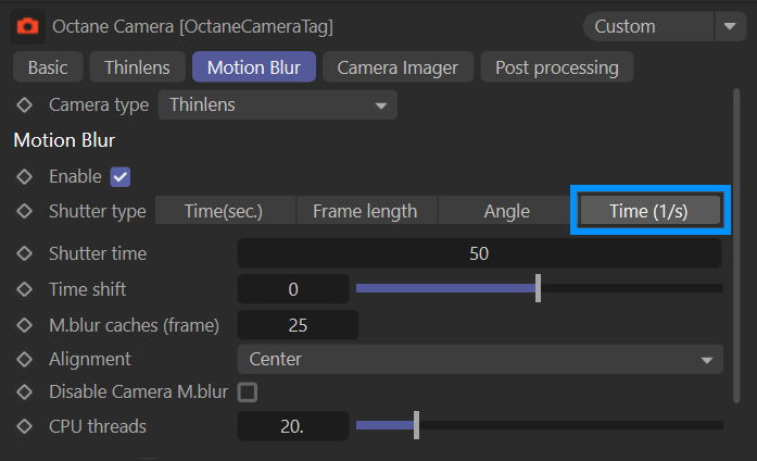

- Time (1/s) — This value sets the amount of motion blur based on the 1/s is a shutter like setting as seen in DSLRs and other cameras. Setting the Shutter time slider to 50 for example equates to 1/50, or 0.02 seconds in the Time (Sec) option.
For a cinematic look, try 50% in Frame Length mode or 180° in Angle Mode, FPS*2 in Time (1/s) mode and 1/FPS*2 in Time(sec.) mode. Frame length and angle have the advantages that they are not dependent on the fps so if you set them up once the way you want, the motion blur length is the same even if you change the FPS.

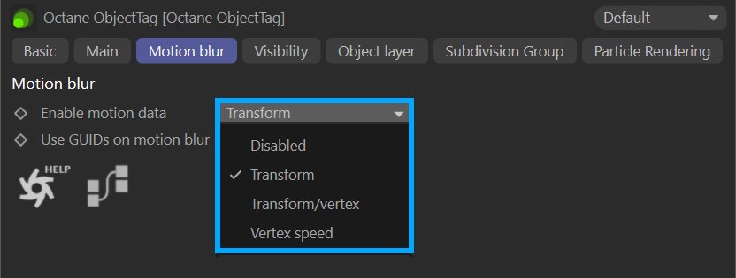

Enable Motion Data
There are four options: Disabled, Transform, Transform / Vertex, and Vertex Speed:
Disabled
Disables motion blur for the object.
Transform
Enables motion blur to the Position, Scale and Rotation transformations of the object.
Transform/Vertex
Motion blur is calculated for both the transform and vertex movements of the object (such as character rig deformations, hair, etc.)
Vertex Speed
This option calculates the correct motion blur for volumetric and fluid flow simulations. Three separate vertex maps (one for each X, Y and Z axis) are required.
