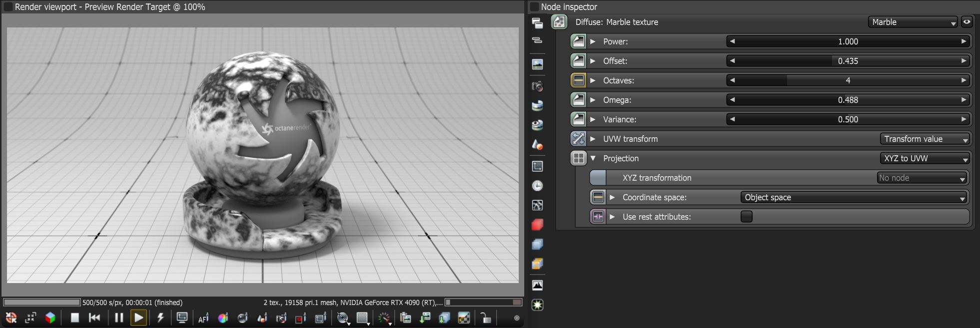

The Marble node is a Procedural texture that can create marble-like noise. It is similar to a Turbulence texture, but more fine-tuned to create marble-like patterns. Figure 1 shows a Marble texture connected to the Diffuse channel of an OctaneRender® material.
Marble
Figure 1: The Marble texture creates a Procedural noise pattern
Marble Texture Parameters
Power - Controls the texture's overall brightness.
Offset - Sets the texture position in 3D space.
Omega - Controls detail in the underlying fractal pattern.
Variance - Randomizes the Marble pattern.
UVW Transform - Positions, scales, and rotates the surface texture.
Projection - Sets how the texture projects onto the surface.
Coordinate Space - Determines the coordinate space for the texture map.
Use Rest Attribute - Prevents texture sliding, swimming, or distortion on animated and deforming meshes by locking coordinates to an base frame.
