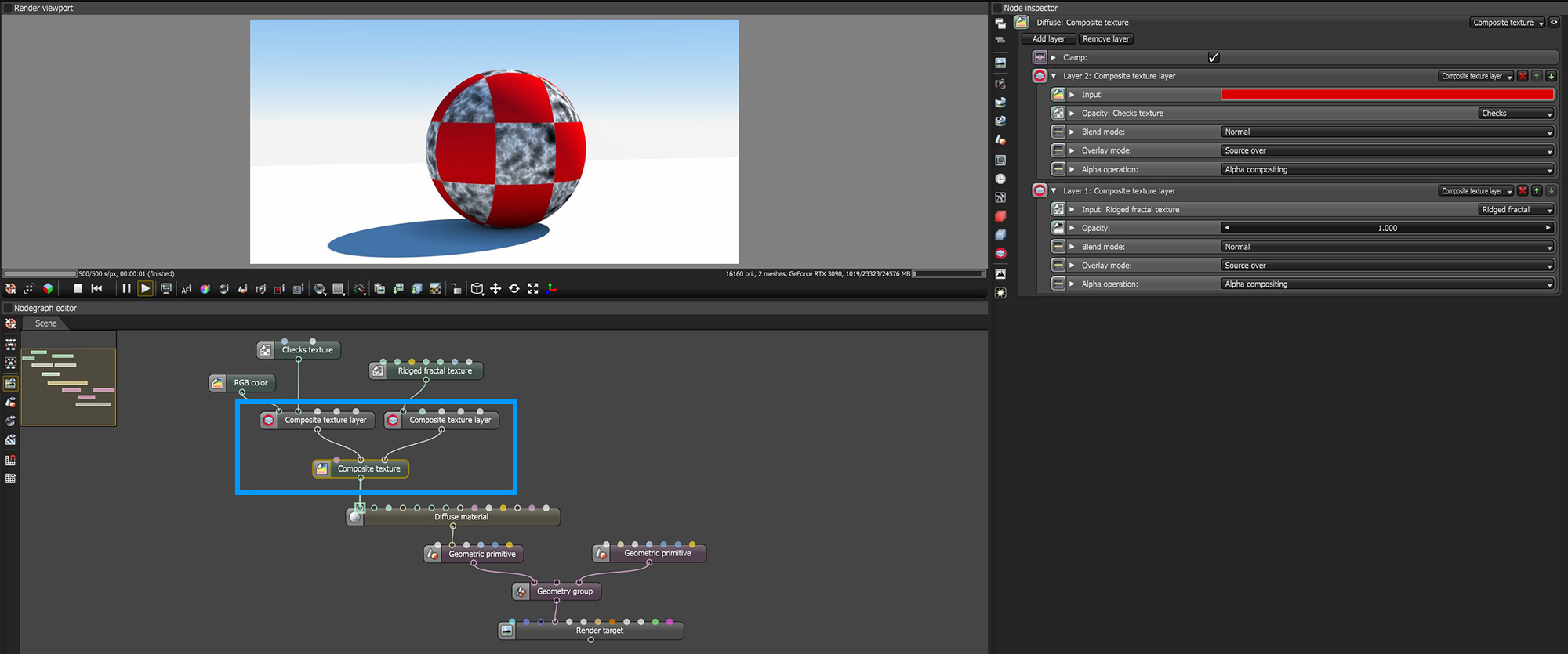

The Composite Texture node is a traditional composite stack for image textures via the Composite Texture Layer node. The composite stack goes from right (bottom most layer) to the left (top most layer). In figure 1, the Composite Texture node is used to mix a RGB Color node using a Checks texture node for opacity with a Ridged Fractal Texture node.
Composite Texture
Figure 1: The Composite Texture node is used to mix a RGB Color node using a Checks Texture node for opacity with a Ridged Fractal Texture node.
