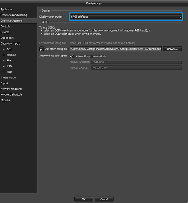

The Color Management options allow for display color management to be activated or deactivated. There are numerous preset that can be selected from the Display Color Profile drop box for each monitor connected to the system (Figure 1). Additionally, OctaneRender® has implemented the Academy Color Encoding System (ACES), which uses the Open Color IO (OCIO) color management standard.
Color management
Figure 1: Accessing the Display Color Management options.

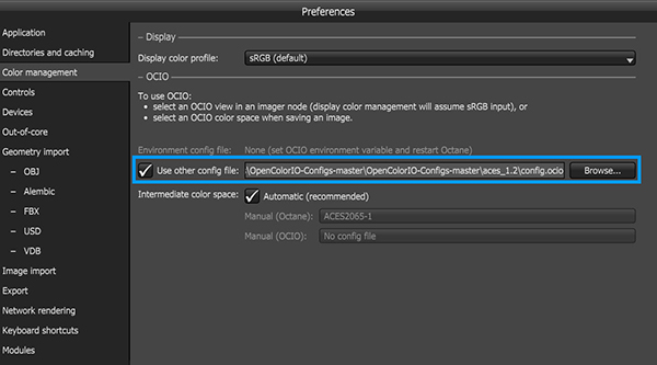

Custom OCIO color profiles can be loaded as OCIO config files from the Use Other Config Files option in the Color Management preferences (figure 3).
Importing OCIO Config Files
Figure 3: Importing custom OCIO config files
