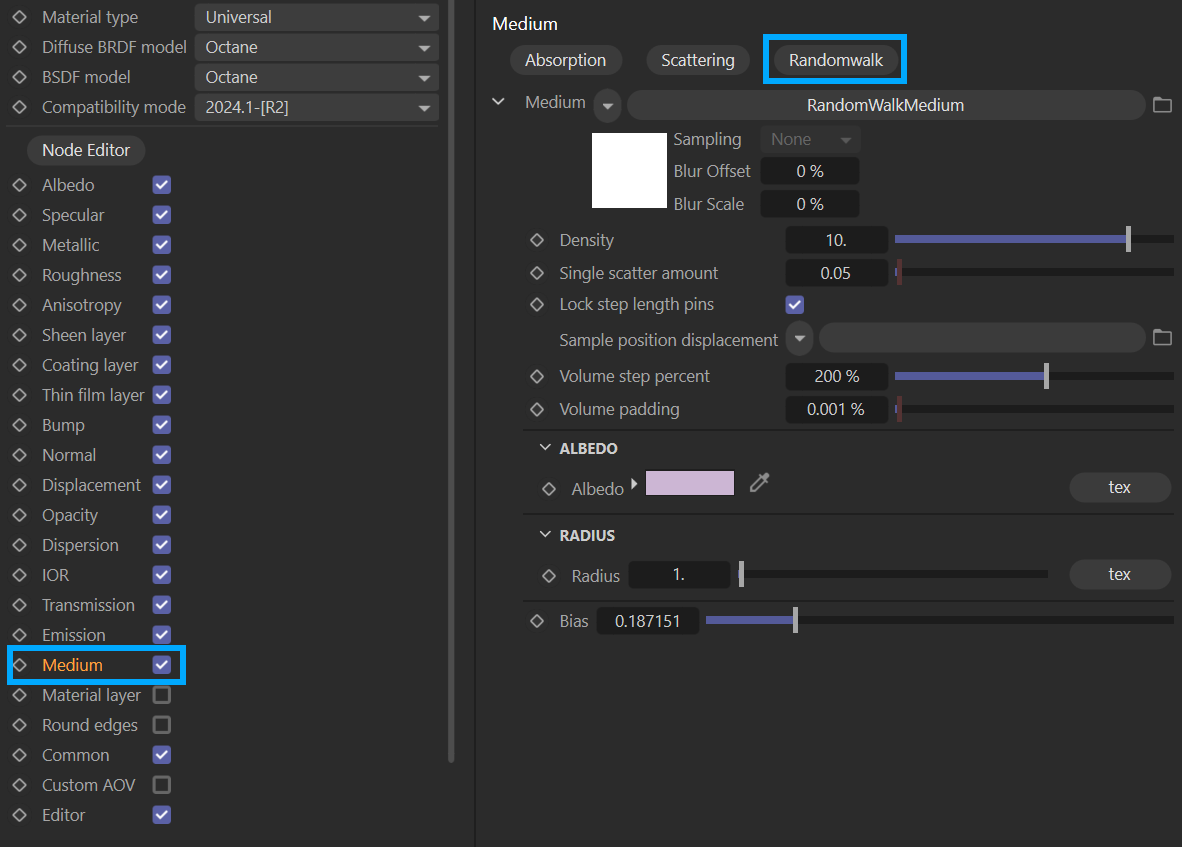

Controls for the Random Walk Medium are available in the Attribute Manager when the Medium toggle is enabled in the Basic tab of the material.
random walk medium
The illustration above shows the random walk medium user interface, as explained below:
Density
Multiplies against the scattering value.
Volume Ray Step Length
The step length that is used by the shadow ray for marching through volumes (hidden if Lock step length pins is enabled).
Single Scatter Amount
Determines how often Octane will calculate direct light in volumes, as a ratio of scatter events.
If enabled, uses the Volume Step Length as the Volume Shadow Ray Step. If you disable this option, the Vol. shadow ray step length slider control will appear, allowing for direct control of this parameter.
Sample position displacement
Allows a texture to control a volume's sample position displacement.
Volume Step Percent
The default value is 400%, but, depending on the surface, you may need to adjust this value. Decreasing this value decreases render speed, and increasing the value causes the ray marching algorithm to take longer steps. If Volume step length exceeds the volume's dimensions, then the ray marching algorithm takes a single step through the whole volume. To get the most accurate results, keep Volume Step Length as small as possible.
Volume Padding
Expands the volume bounding box by the given percentage in all 6 directions, but only if sample position displacement is being used.
Albedo
Specifies the expected SSS color; use any color, procedural or image texture node.
Radius
Specifies a color radius texture, which represents the depth that the light scatters into the medium.
Bias
The bias slider interpolates between the unbiased vs biased scattering in the medium. The biased scattering method (when bias is 1.0) enables faster convergence, but also allowing you to mix the two methods for meshes with high curvature.
