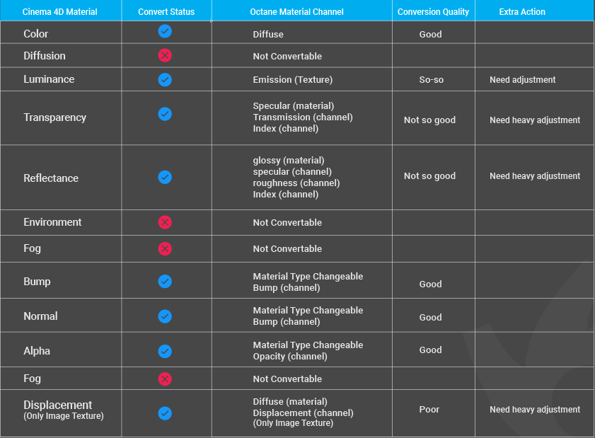

Cinema 4D standard Materials
The illustrations below show the various Cinema 4D channels and the resulting conversion to Octane material channels. The table at the end of the topic contains the conversion results of all channels.

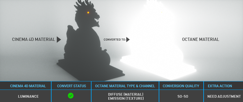

convert materials — luminance

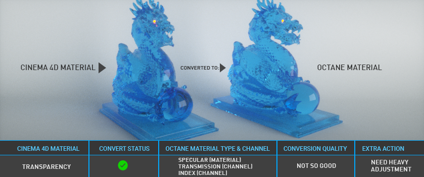

convert materials — transparency

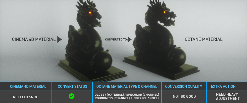

convert materials — reflectance

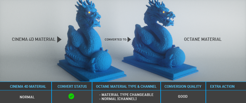

convert materials — normal

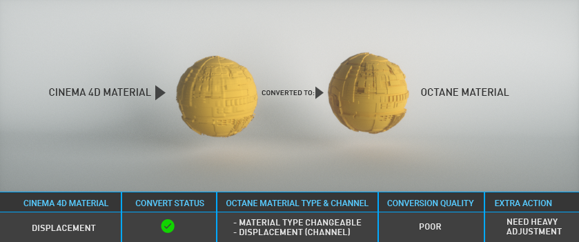

convert materials — displacement
standard c4d materials conversion table
